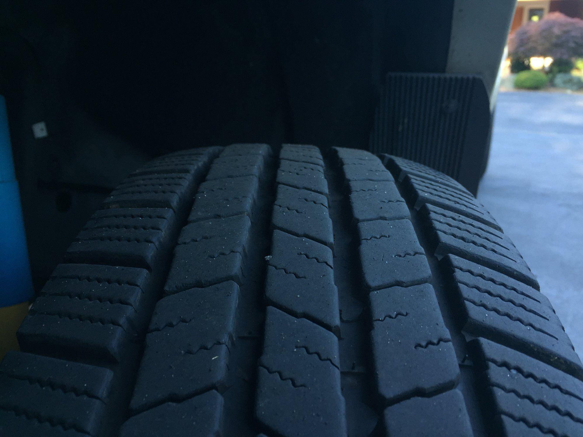

You want the best ride with great tread wear get these! I tow 33-35K combined and I am at FULL RAWR.
Almost 20k on these.
The Bridgestone Duravis R500HD is a commercial grade tire that comes in the LT235/80R17E size. These tires have a two ply poly sidewall while most have a single ply sidewall. They wear like steel.
You might try two on the front axle. SnoKing

"The best ride trades off "crisp" handling for a soft sidewall tire that wants to track the grooves in the road and squirm."
NOPE not one bit with these tires. They track great and corner great. Simply put YA GET WHAT YA PAY FOR!

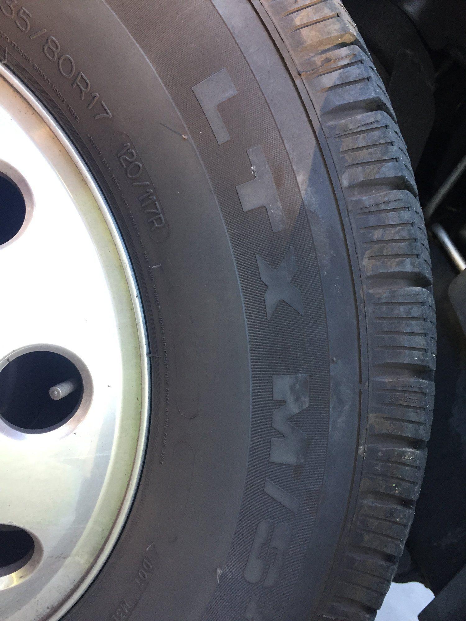

Similar situation with my 2017 3500 DRW...my stock tires (rear) are about shot with 57,000 miles so need some new treads. Although I live in CO, we don’t hang around for the snow anymore! So looking for nice ride and long life! Sorry for the ignorance but is the LTX a Michelin tire? Would be interested in comparison between LTX and the Bridgestone...?
Thanks,
Bob

I have run the Michelins and forever, we go over Donner Pass frequently and it isn't unheard of to get caught in some snow...pulling the 5'er. My biggest gripe with them is they weather check quite a bit. I keep my tires covered if the truck isn't going to see the road for more than a day or two, and with only 48k on it that is a lot, LOL.
They were new when I bought the truck but I had 2 sets of them on my prior rig and got tired of the weather checking and dealing with pro rating them. I bought new Toyos for it about 3 months before I sold the truck. If these new Michelins check, when they go away I will get Toyos again.

RAM DRW trucks WILL have "STEPPING" on the front tires unless you change the factory 1/4" Toe to 1/64-1/32" plain and simple!
20K on these with ZERO stepping.
