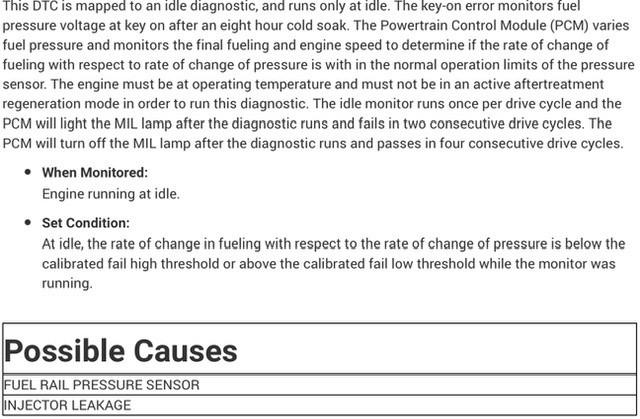

Just so you know, P0191 has nothing to do with the filters or low pressure side of the fuel system. It’s all about rail pressure at idle on a cold start. This is from AllData.
