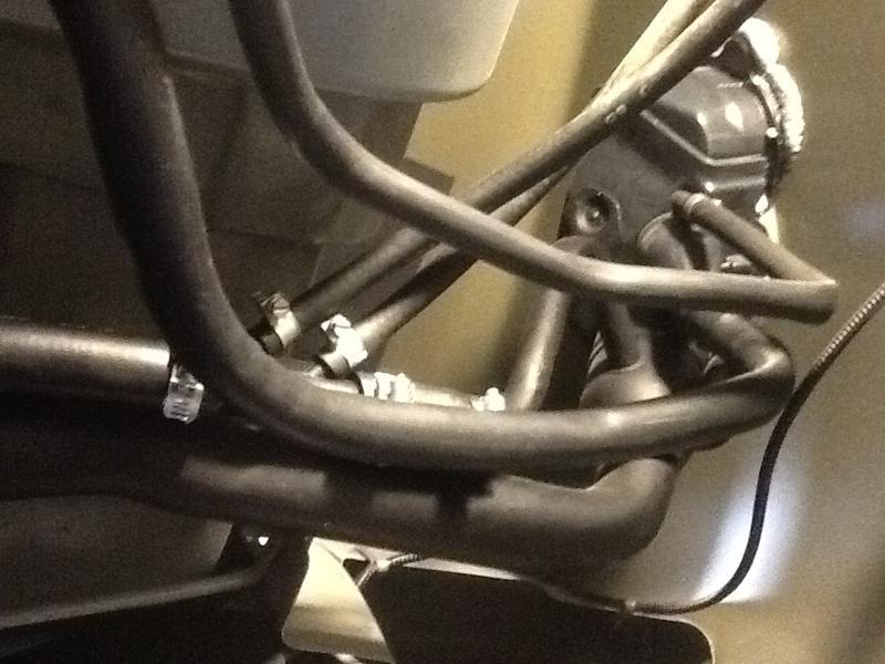

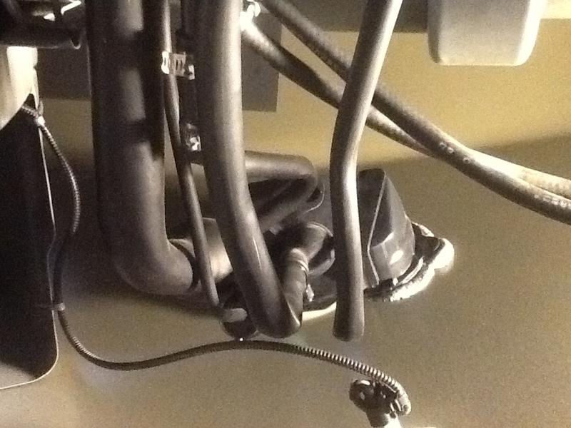

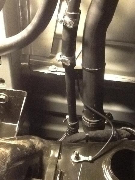

Here's some pics.
The small line in the top pic is the vent that is hooked up on top of the tank to a barb. It has a small vent canister attached that leaks fuel if you try to top off the tank, this is the one zip tied to the DEF fill line in the Pic. The larger vent tube that I cut and put a Y in for my Transfer Flow, vents back to the filler line. I believe it is attached to the top of the fuel pump module but I haven't dropped the tank so I can't say for sure.
