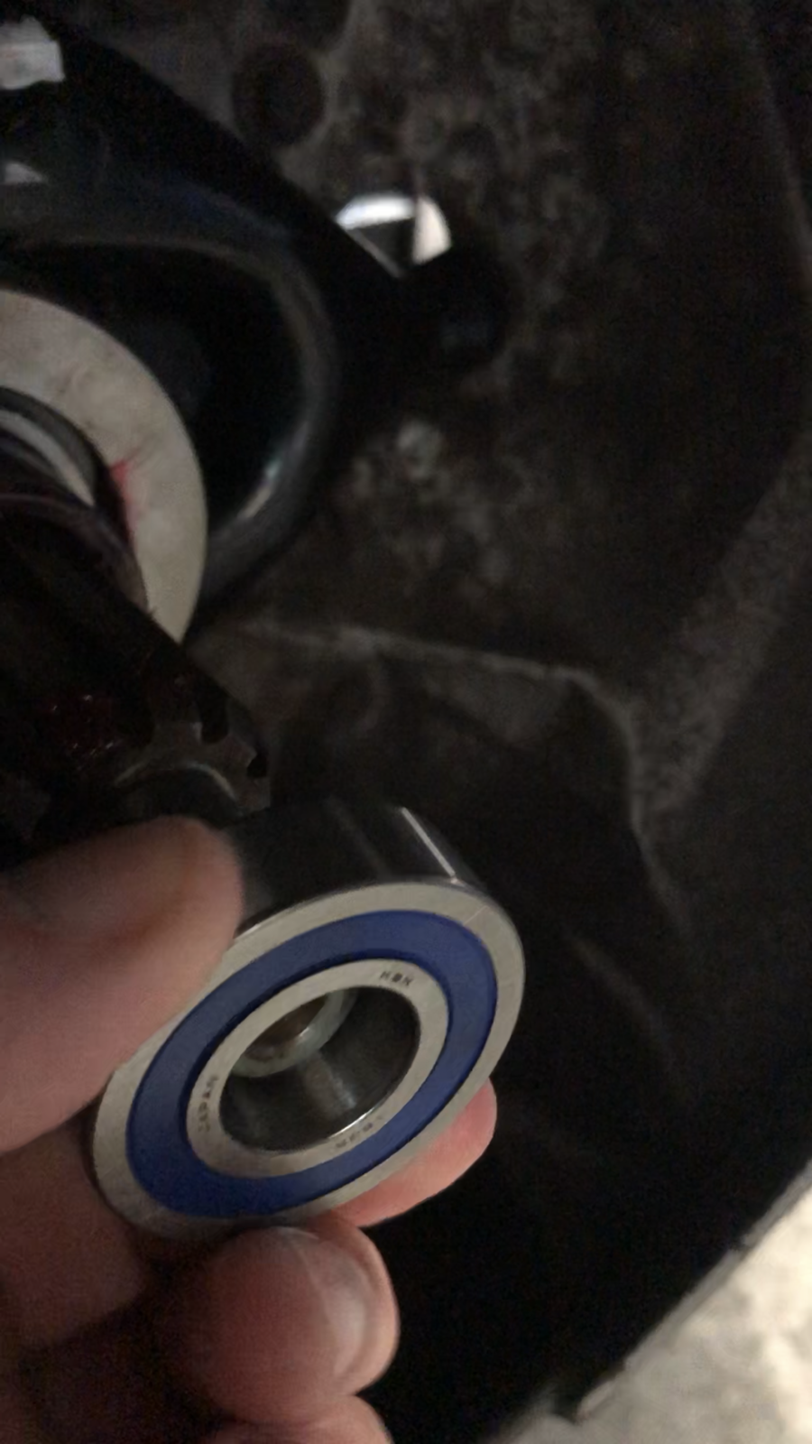

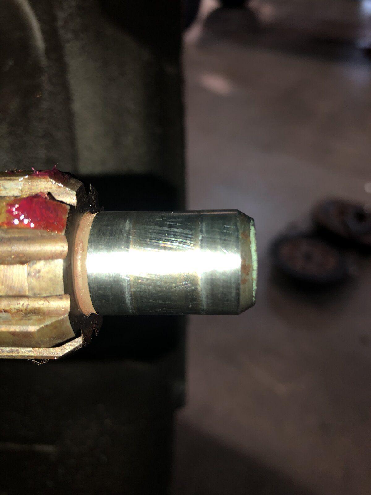

Traveling cross country I thought it would be time to replace my stock clutch that had 160K miles. Since I was going through central Texas I thought I’d take my truck to the experts at Standard Gear and Transmission in Fort Worth. I’m sure glad I did. While they had my clutch out they found my input shaft worn. Based on their advice I decided to replace it. Then when they had it apart they found some synchros bad. Since I was traveling through town they put their other jobs aside and prioritized my repairs. They had all parts in stock and are definitely the experts. Any other shop and I probably would have been stuck longer or not able to fix my transmission at all. I highly recommend them for transmission repairs.

If the pilot shaft wear is the reason they replaced the shaft the driver is in control of using the service life of the pilot bearing/input shaft surface. At a stop light select N whenever possible and safe, clutch pedal UP. No pilot wear. But if you hold it in gear at a light pilot service life is being used.
That lets the pilot and input shaft spin at engine RPM not engine RPM for pilot vs a stationary shaft.

First thing I had to do to my 99 2500 after purchase at 80 K miles is replace the pilot bearing as it was powdered and seized and could not get into or out of gear with engine running, at the light. I did not replace the input shaft (just cleaned it with purple scotchbrite) and it lasted over another 100K before the NV4500 started to come apart at the output end of the transmission and this was self caused by me using wrong lube.

Thanks for the tip. I’ve always put it in neutral since new. I blame it on Dodge for using a crappy pilot bearing. I did have a bad habit of resting my hand on the stick. I also had to learn not to climb hills or use my exhaust brake in sixth. It used to pop out of sixth sometimes. They replaced reverse which they said was common for my mileage and a few synchros. There was also a bearing underneath one of my gears that was toast. I was kind of surprised to see the damage since the transmission was acting fine. I feel lucky I caught it before anything failed.

South Bend provides a sealed bearing with their clutch kit.
