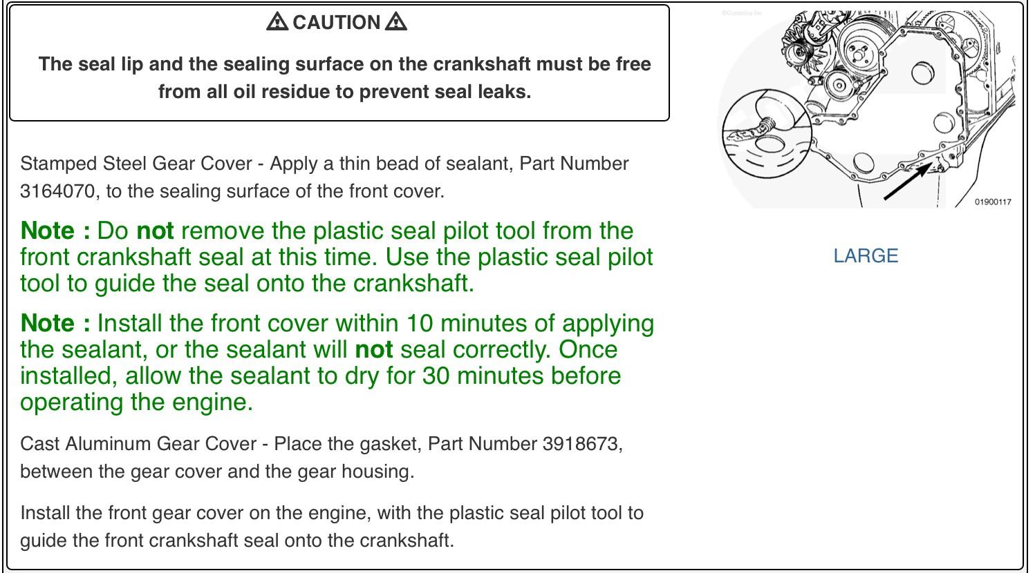

This is from the Cummins SM. Evidently there’s an aluminum gear cover that takes a gasket but you’re to use sealer on the stamped steel cover.

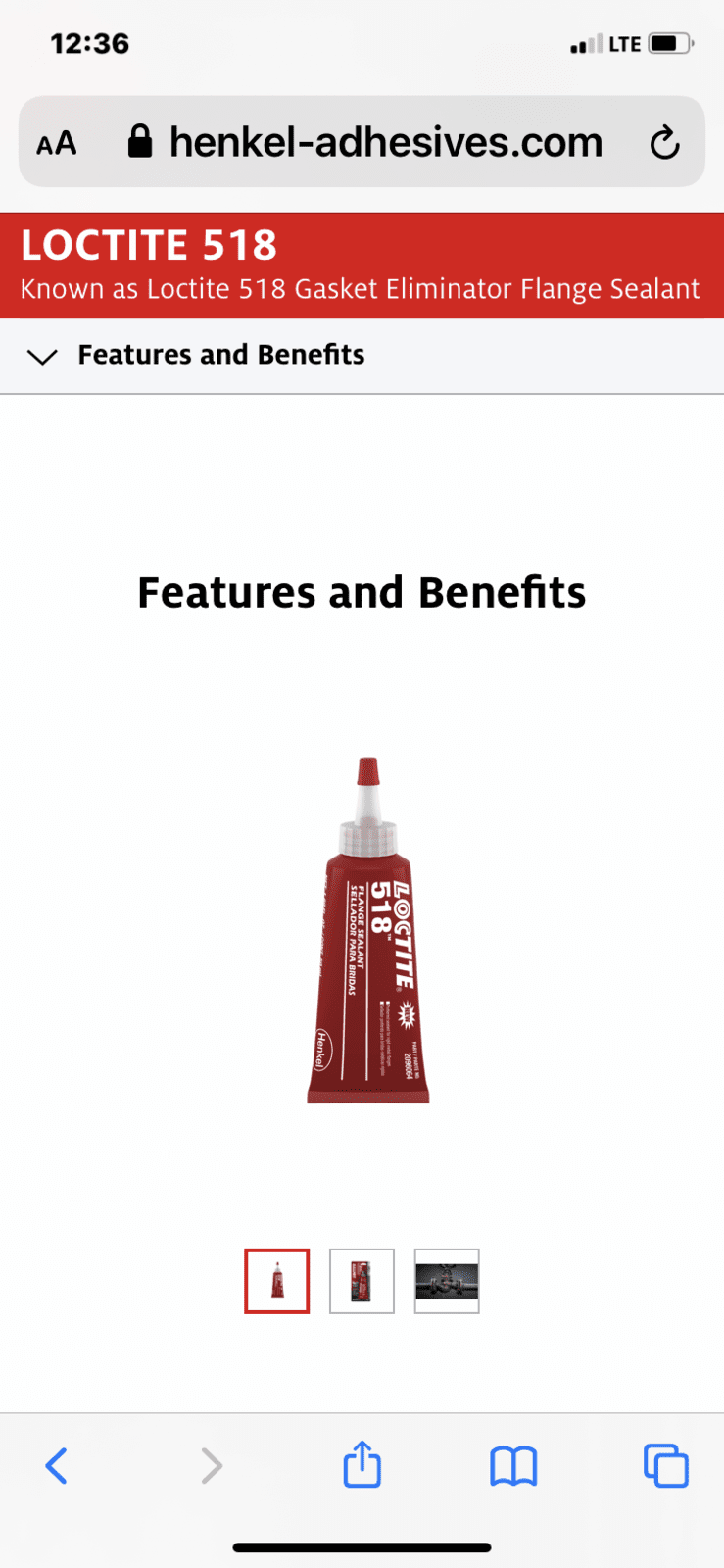

518 not 15Thanks . I used a gasket we stole out of my buddies engine kit which is a felpro and loctite 515 I don’t think I’ve ever had anything when I’ve used 515

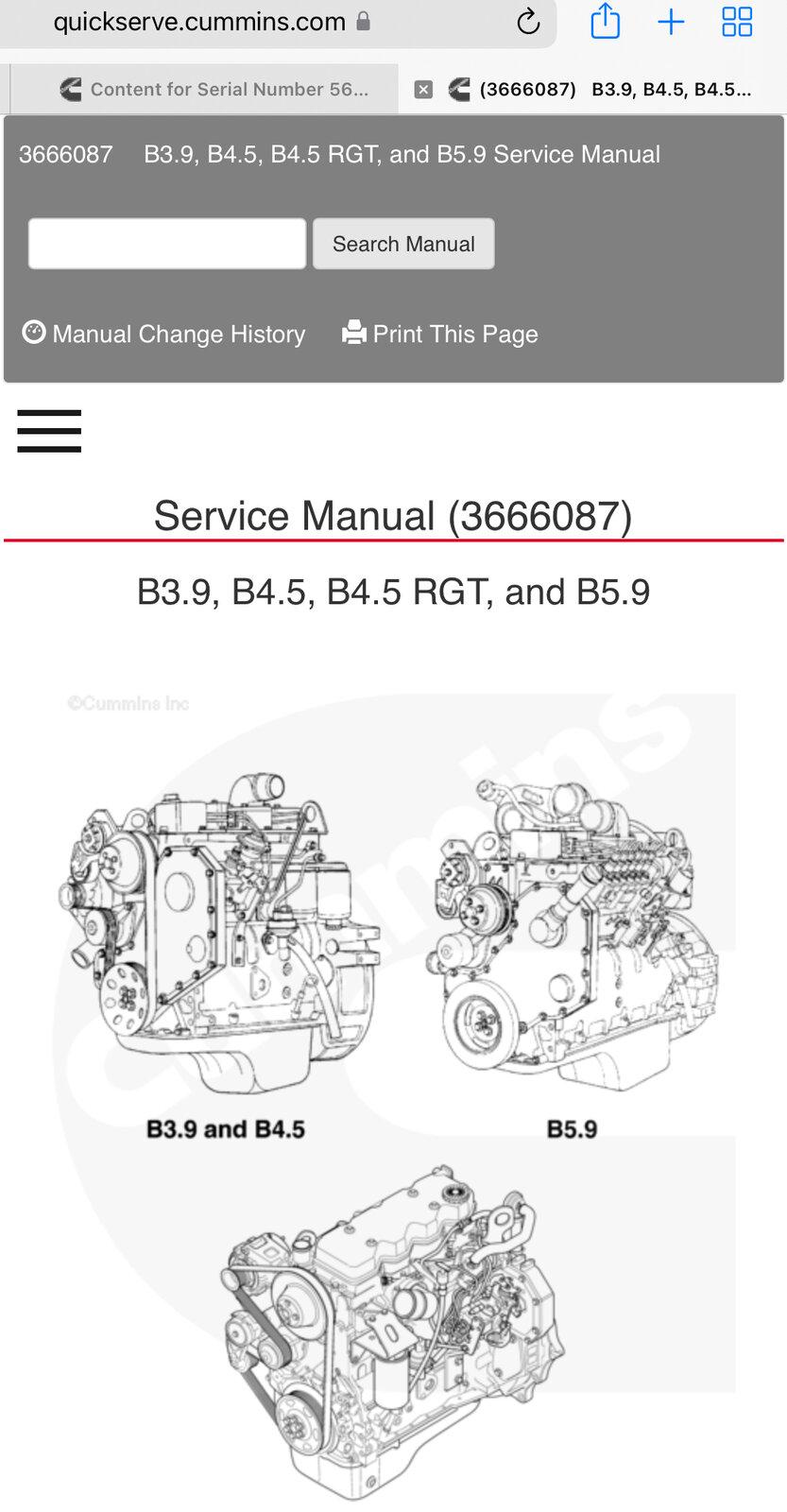

Yep, that one is straight out of this manual for the B5.9 12-Valve.

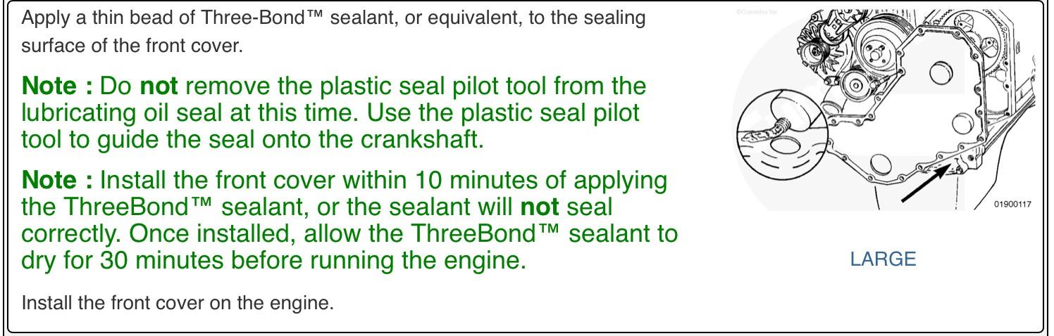

This one:

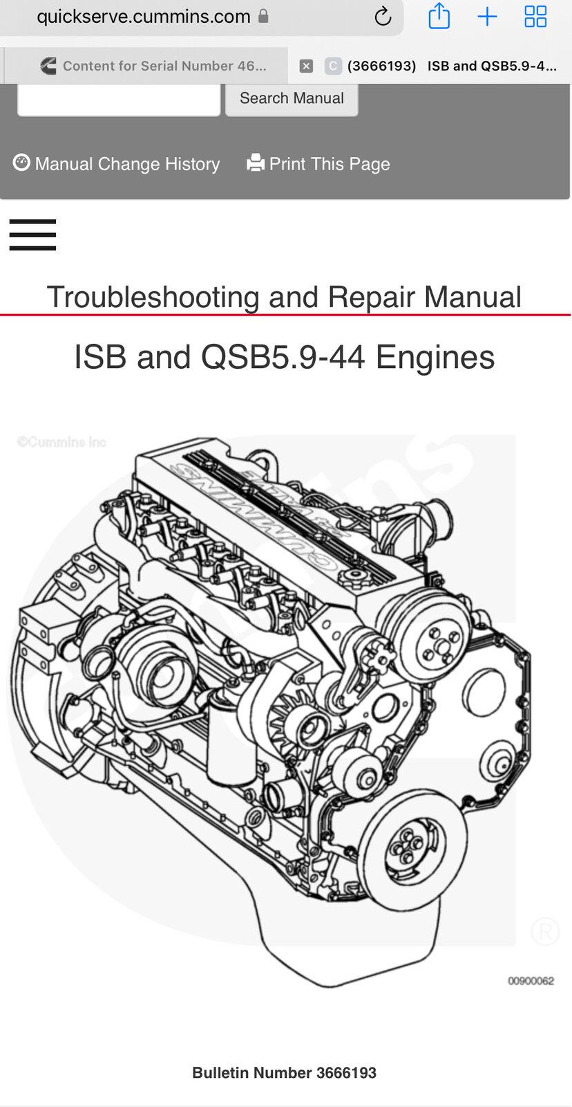

is out of this manual for the ISB 24-Valve.
