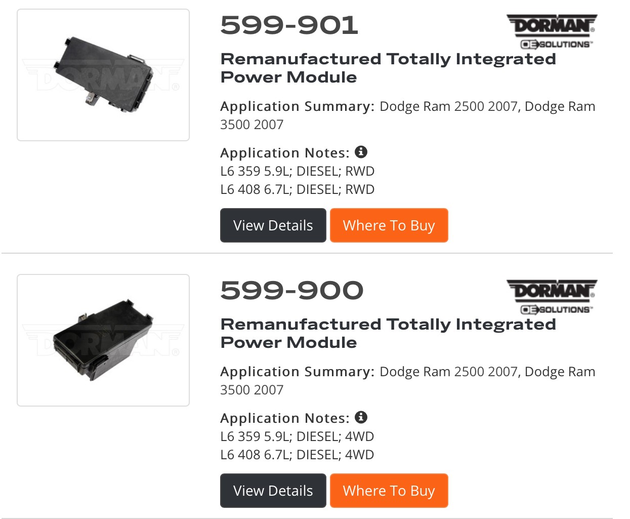

Looks to me it doesn’t matter if it’s a 5.9 or 6.7, just need to know if it’s RWD or 4X4.
okay I've used Dorman before it says plug and play no programming necessary which is what I've heard is the biggest problem kind of like the built in exhaust brake having to be programmed if this works it will be a blessing to me and our company
