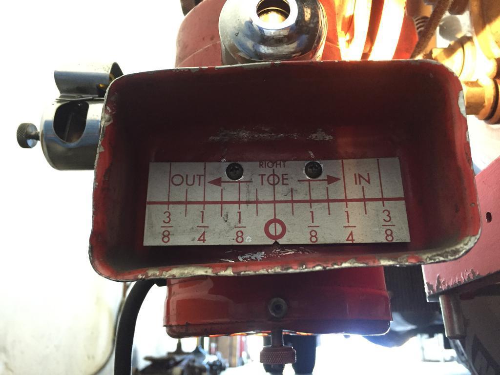

the issues is alignment shop set in degrees, not */32's. you have a solid front axle yes? or did you order a 2wd?
if 4x4 set total toe to 0.
OH really???
i gotta give you props on that one. i haven't seen that old of alignment rack in a while.

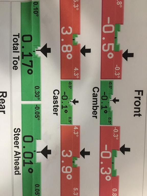

here's more modern print out.
But if it works it works. no shop around me uses those kinda measurements. it's all Degrees.
i'm sorry for misspeaking.
