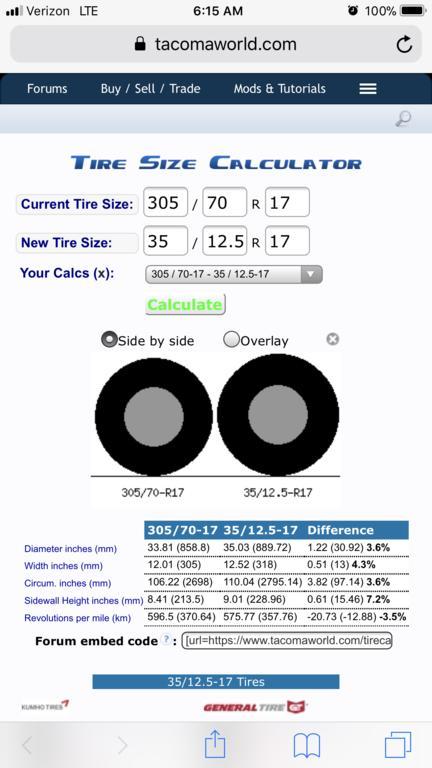

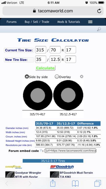

Im in need of new tires and want to go up to 35" from my 305s (~34"), In looking I see that 12.5x35.17 and 315x70x17 are virtually identical in their specs but not their price. Can anyone enlighten me as to what Im missing? load, height, width, everything seems to be the same. If Im not overlooking something thats key, what is the better choice or does it really come down to price?

cool calculator, I used the provided specs on a couple of different websites but hadnt seen that before, thanks
