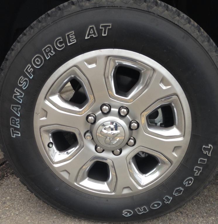

Edit: deleted. Most of what I wrote had to do with stock truck with stock rims. You are using non-stock rims I think so it doesn't apply. But I cannot seem to delete the image I attached.
One thing to consider is the spare. There is not much extra room for a larger diameter tire.

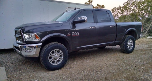

What size tires are those?
The person who owns the truck and originally posted the picture said they were Toyo AT II LT285/75R18. I recall he said they did not rub.
I ran in to a guy that had the 295-70-18's Goodyear's on stock 6 into 12 spoke wheels as shown on the Pic above from Badunit. They looked AWESOME filled the wheel well just enough. Did Not rub or mess up the Speed O meter or gear ratio too much. Only down side was they are only available in an off road tread.
When I was looking for tires two years ago I took notes that said 295/70R18 will fit as a spare. I cannot verify it, though. It looks like it would be a tight fit. 285/75R18 are taller and most likely will not fit as a spare.
