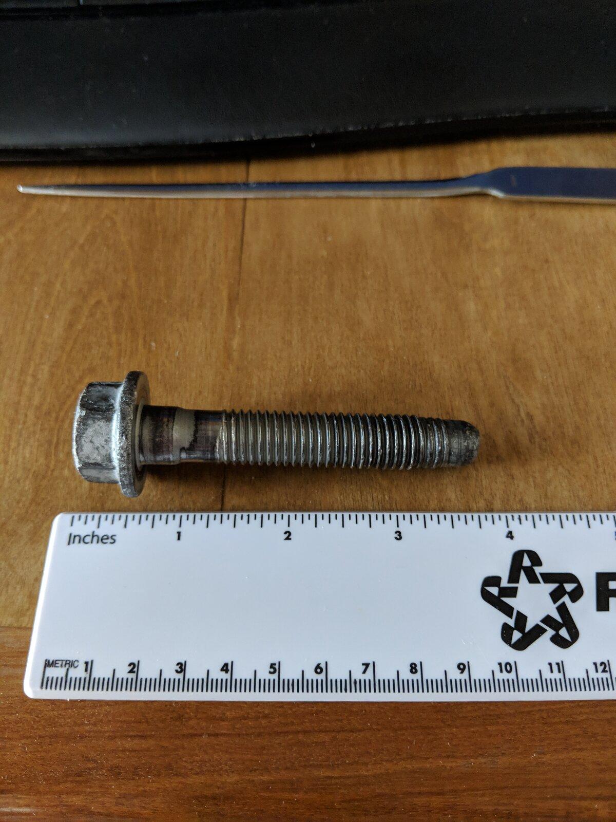

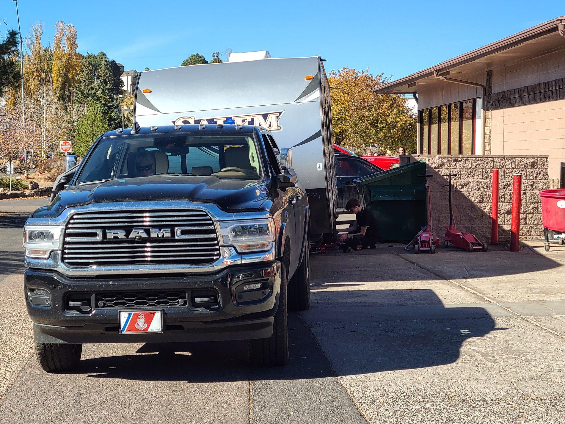

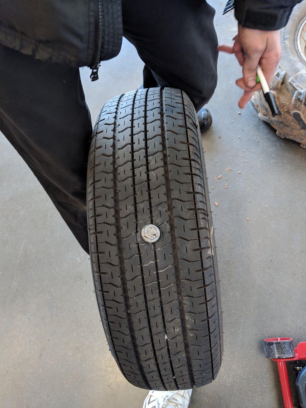

View attachment 131435 Got a late start this morning leaving Flagstaff AZ after having 4 new Goodyears put on the money pit. Damm! I'm just trying to get home lol! 2 blow outs, and 1 puncture flat in 3 days. Getting tired of rolling around on hot asphalt.
Bummer…. But that’s why I won’t spend money on ST tires.
The asphalt isn’t the problem, it’s just showing you the issues with ST tires.
