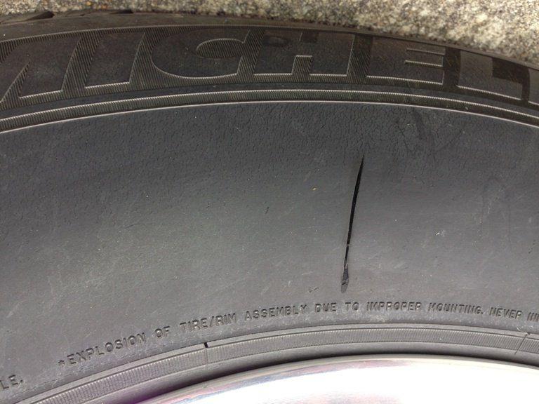

Doing a tire check this AM and found this on sidewall. Looks like time for new tires, aarrgh. But better spotted than blown. Any comments from the gang on what it is or cause? I don't see any scuffing around it or on the rim.
gary
There was a recent recall on certain Michelins not long ago. Do not know the details. I did have the same exact thing happen on the spare tire on the 5ver that had a tire cover on it so I do not think anyone jumped the block wall, removed the cover and slit the tire. This particular tire was a Goodyear.
Dave
Looks like you ran over something that cut the surface, a little too uniform for checking. Could also be somebody playing with sharp objects.
Time for new tires anyway, you have weather checking going on there.

Thought it over and its going to my tire smith tomorrow, tires have given me about all they have and I'm not even considering any tire other than the same Michelin. Just not thrilled about the expense, bad timing.
I had a comparison card made by Michelin to use to comare your sidewall checking to their good, bad or ugly chart. I don't think the weathering on these sidewalls hardly even made the chart. Chart is gone, gave it to an RV saftey training guy.

Not sure exactly how old the tire is. Most likely about 5 years or so. I even have my original steel wheels and tires stored in garage that if I wasn't towing once in a while still have some mileage left in them. Got a trip coming up and needs to be tow worthy. If any of that makes sense.

Front tire will stand a road hazard up. rear tire will come along and hit it a very high percentage of the time. Tandem axle trailers and trucks have a much higher rate of flats / damage on the rear set of tires as a result of that phenomenon.

I had that happen a few years ago on my Goldwing, flipped up a lag screw and thud right into the rear. Babied it to the town, got it plugged and on my merry way. No telling what happened yet, truck is getting 4 new LTX MS2 tomorrow, talk about sticker shock!!!!

The sidewall picture looks like it was done with a sharp object, knife or such, but the top end of the cut looks strange for a knife or razor blade, don't it ? Seems like it should be a cleaner end cut ?

I might get a "pros" .02$ tomorrow but even with the tire in hand, bet it might be a stretch to get a yup, it was the Colonel in the library with the lead pipe conclusion. Guess its just my day to moan a little bit, still working helping keep Jim happy and voulnteering still I hope. Hey Jim, how about a day with Habitat for Humanity the next time you think one of MY dollars hit yor direct deposit find me if you can account, OK!
AnOldBiker.... I agree, it does look like a cut.... like some kid did it with a dull knife.... years ago.... I mean years ago we had to cut tires after we adjusted them.... across the serial # so that no one would pick it up and try to get it adjusted again... the cut mark looks like someone who's never cut a tire before.... just my thought...

I'll at least get an opinion tomorrow from the tire shop and a wallet lightening too.
