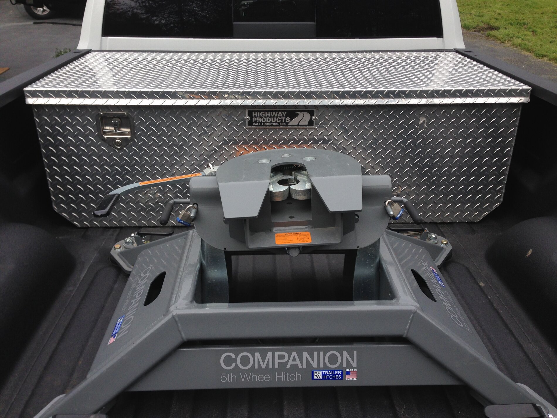

Anything that sticks up can be a problem. Personally I would go with this, Highway Products bed height 30" front to back box. I have used this one since early 2,000's starting with my 98 12V.
A friend has a 19 RAM with 8' box, He did sorta listen to me and got a below rail cheap 18" front to back tool box but has not removed the MOPAR tri fold top as I told him the first time he is in a slow tight corner with the terrain dipping and twisting he will be punching a hole in the front cap of his 5er. I asked why he has not sold the cover, he said "because I like the looks of it".
Same goes for these tool boxes that set on the top rail sticking up 3" or so.
