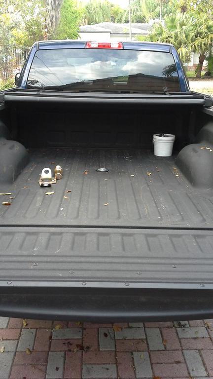

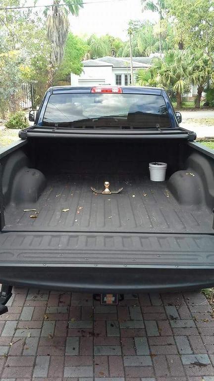

Just wondering if anyone is experiencing a lot of dust inside the bed on dusty roads with the tonneau cover closed. Don't remember having an issue with my previous truck with the same tonneau cover closed. Its coming up thru the tailgate, and the plastic covers on the fifth wheel prep. Everything I put back there is covered in dust. Mine is the 2014 Megacab 3500.
I think the culprit for me is the hole in the bed for the gooseneck hitch. It has a vinyl cover for the cap, but it's not air tight.

Its looks like someone dumped powder of some kind all over everything,. Its actually a mess . A lot of it is coming up thru the bottom of the tailgate, thats where its the deepest so to speak. Just can't remember having such an issue with other trucks. Will just cover with a tarp to keep the dust off the camping equipment

Its a soft cover TruXedo. No does not cover the stake pockets, but they don't open up inside the bed. I rolled the cover up ,and looked inside where the tailgate meets the bed, and there is no way dust can stay out. The bottom looks fairly tight, but the sides towards the bottom have a lot of space between them and the tailgate . Looking down from the inside you can actually see the ground .

I don't think its getting in from my cover, not the way the tailgate fits, I think that is the issue.
I can't imagine how yours would stay dust free, unless the 2016's have a different fitting tailgate. There is really nothing stopping the dust from coming up from underneath between the bed ,and tailgate.
You are right the tailgate does not seal much at all. I was going to get a tailgate seal but haven't had any issue with dirt/dust and only minimal amounts of water get in. I Think the dust in the bed has a lot to do with the soft tonneau covers as they act like a huge bellows when going down the road. The constant up and down flapping causes the dust to be sucked in and then settles in the bed. Obviously some soft tonneaus would be better than others depending on how much movement there is while driving. With my hard tonneau (Bakflip VP) I have never had an issue with dust in the bed. You could try a tailgate seal they are fairly inexpensive and it may help.
Thanks, that really does make sense. didn't know there was such a thing as a tailgate seal. My soft cover has minimal bellowing, but I can see where that might cause an issue. The largest concentration of dust is right at the bottom of the tailgate inside, and around the fifth wheel prep caps.Of course everything is covered in dust . For now I'll just cover everything with a tarp, with the tonneau cover it will stay put.
