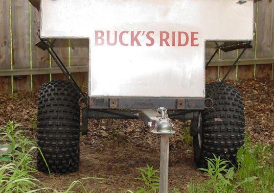

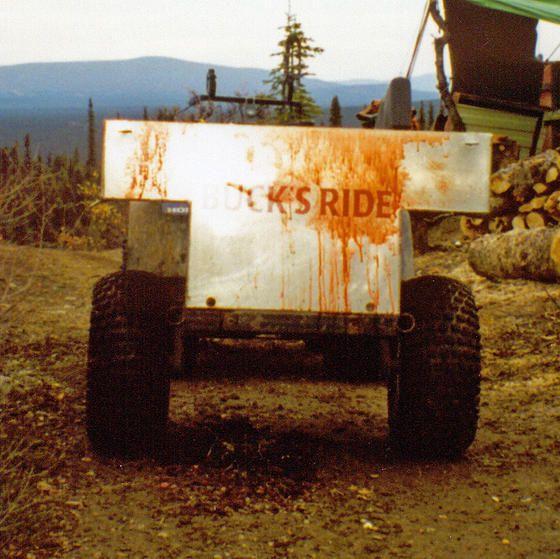

If you build one, I agree with Nick, over rate them so they don't slip around a notch for being over weighted. I have towed allot of TT's with the Tor-Flex and they are so much smoother than springs it's not funny. When I built my meat trailer in Anchorage I had this little jewel (see photos)built for the underside by Dexter. I believe I did a either 18deg. or 22 degree downturn with a 1200 lb rating. And what a difference it was from going from the straight axle to towing the meat trailer loaded thru the "Rock Garden" on top of Moore's Mtn. Rather than the trailer just boucing up and down, rocking from side to side, with that tor-flex axle the trailer load stayed paralell to the ground and those spindles side to side gliding up and down sucking up the rocks. . . unbelievable difference. Was able to comfortably make way better time without worring about the trailer rolling over on it's side. You can order them in either upturn or downturn depending on where you want the trailer in relationship to the ground. This meat trailer measured at 18"

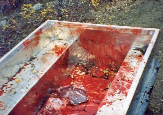

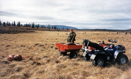

I used the heck out of that thing, for packing the camp provisions in for a couple of weeks. Or cutting brush to get the meat back to camp from the kill zone. That trailer would take a good sized Caribou whole or 1/2 of a good sized moose comfortably. I had a whole moose in it once and it really was a load, real hard pulling and all too funny to look at seeing all four 4' legs sticking up in the air and hanging over the sides. This one photo had that night's liver dinner in it. The place we hunted was 6 hours plus of hard off road travel/brush cutting on a four wheeler to get into our camp/hunt area. So unless we got allot of meat to pack out you only wanted to make the trip in and out only once.
