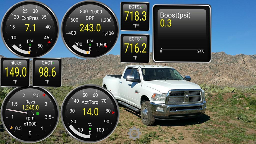

In the Torque Pro app there is a standard PID I added which simply reads "DPF Pressure" and is identified as measuring PSI. This thing measures up over 1000 at WOT.
It's not the ExhPres PID. This one maxes at around 4 and is normally in the .4-1.0 range, so I figure this is the exhaust differential pressure.
What the heck is that DPF pressure reading??
Also, cruising unloaded between 65 and 70 for ~30 mins what would you expect EGT 1 and EGT 2 to be reading? I'm hoping what I saw was a regen in progress, as I was 1170 and 1000 deg F, respectively.

Cruising along on flat land it's in the low double digits. Notice the red mark showing max... could blow a gasket like that :)
I got torque pro set up in my 10" tablet and talking to the OBDII dongle. Put up gauges for all 4 EGT B1 data points. I am curious where in the exhaust system (from exh manifold to post scr) these data points are coming from.
