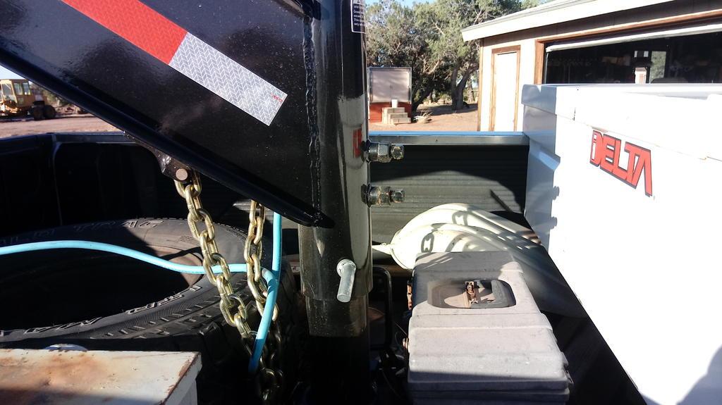

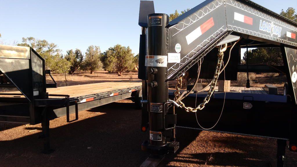

If I remember correctly, the pinch bolts on my horse trailer and flatbed goosenecks aren't flat faced bolts. The have a taper and a kinda different looking edge that makes them bite into the pipe when tightened. I don't do the torque wrench thang, i just tighten them like I mean it. Look at the marks on your pipe and you will see where the bolts bit in just a little. The bite and the pinch WILL hold. You aren't going to hurt the pipe. There is nowhere for the pipe to collapse. Hold the tight bolt still, then make real sure you get the jam nut tight, then drive and don't look back cause your're good to go unless a Chinese space station or a meteor falls on the trailer!
Like I said, my trailers all have the locating pin, so this may or may not apply.

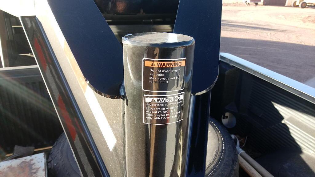

The torque specs are all across the board for different mfg's.

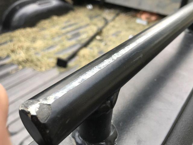

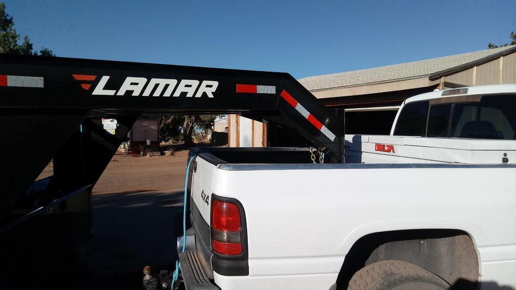

Here you can see where I tagged the corner of the bed. Both sides got hit going over a hump and making a tight turn. If it wasn't for the rails, the bed would have eating a crap sammich.

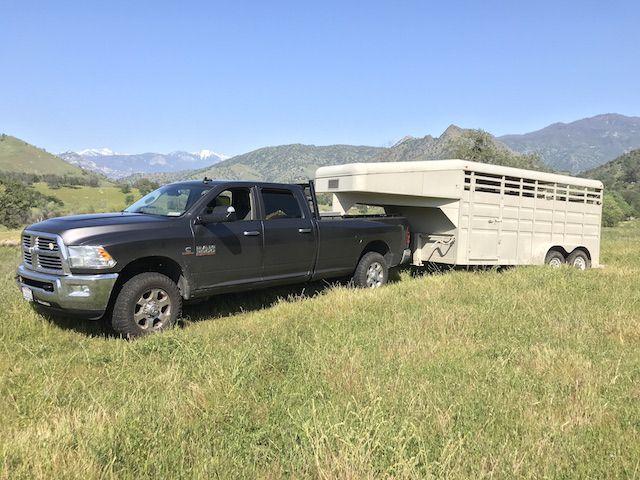

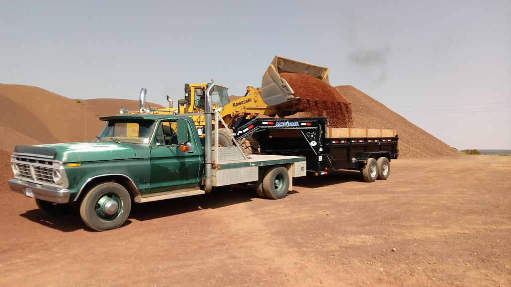

Or without the rails it might have missed:D Your gooseneck hitch must be straight horizontal, note the drop angle in the third picture. Mine has at least a foot of clearance.
Nick
This trailer is 93 so it was built for yesterdays pickups. I've got about 7" clearance on level ground. Like I said, first time in almost two years......I bet it won't be the last.

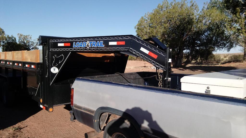

:-laf Yes, a flatbed will clear by a mile! The new trucks are tall. Big difference between my '91 4x2 and the '01 4x4.
