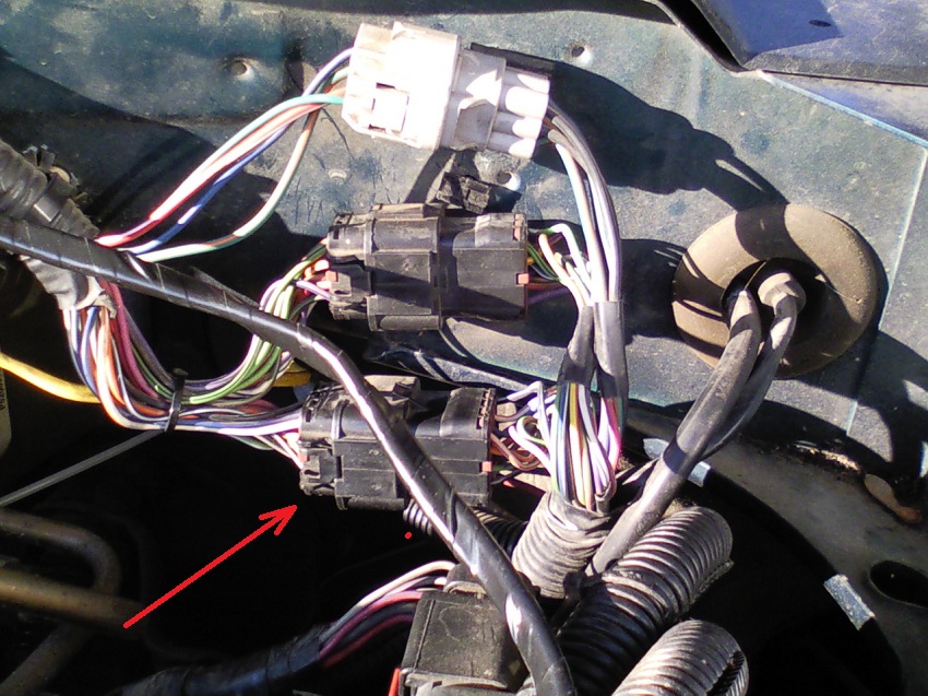

I had a similar situation when we put the engine in my ‘98.5. Finally one day I bumped a connector on the firewall with my elbow and it died. I had previously checked it but obviously not good enough.
Check ALL your connectors in the engine bay. Try to pull them apart then push them together. The culprit on mine was this one. As I said, I thought I’d already checked it, and if I had not bumped it, I may never have found it.
