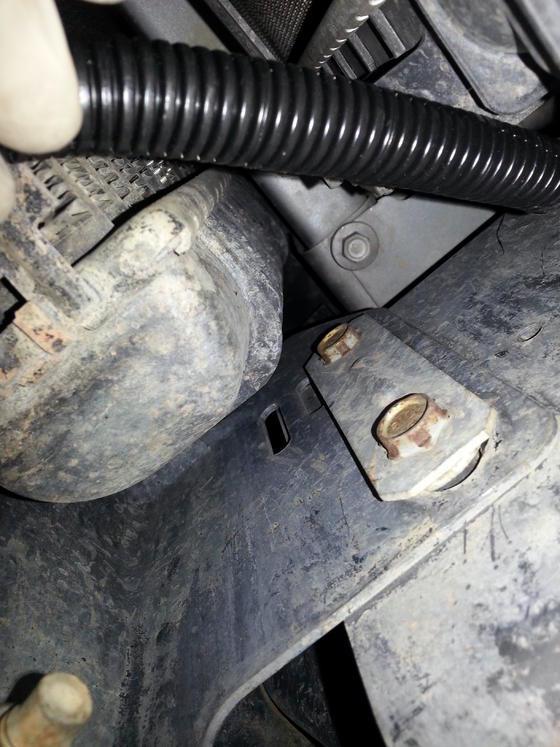

Finished the tow hooks today and while it wasn't a difficult job it sure took a while. The hardest part of it all was getting the bumper aligned perfectly when I was putting everything back together. More my fault since I have a problem making sure everything is perfect, which took some time.
I put tow hooks on my 03 and didn't have to remove the bumper. Just do one at a time so you don't loose the alignment of the bumper. The OEM tow hooks are not good for using a chain as you'll scratch the paint up on your grill and bumper with the chain, so I welded hooks to the sides of mine before I installed them.
I'd have to say it'd be impossible to put them on my 2005 without taking off the bumper. I tried a few different ways and then talked to a Dodge tech and after he looked at it he said the same thing. Crap, I had to loosen the darn intercooler to and push it up just to get the bracket bolts back in place. Like I said not hard, but a time consuming process. I'm guessing the 2003 bumper is a bit different or maybe the frame is at that location.
It's been a few year, but I think it's impossible to put them on with the full support bracket without removing the bumper.
