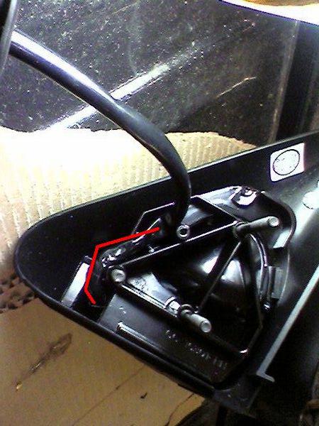

Most important thing is to sure the wire loom is in the right spot on the back of the new mirror mount, if it isn't, when you tighten the mirror down, it will cut the wire loom in half. Twenty years ago, Kool Vue didn't mention that in the instructions and many of us had to learn that the hard way......:( Here is a pic that was on the TDR way back then.....

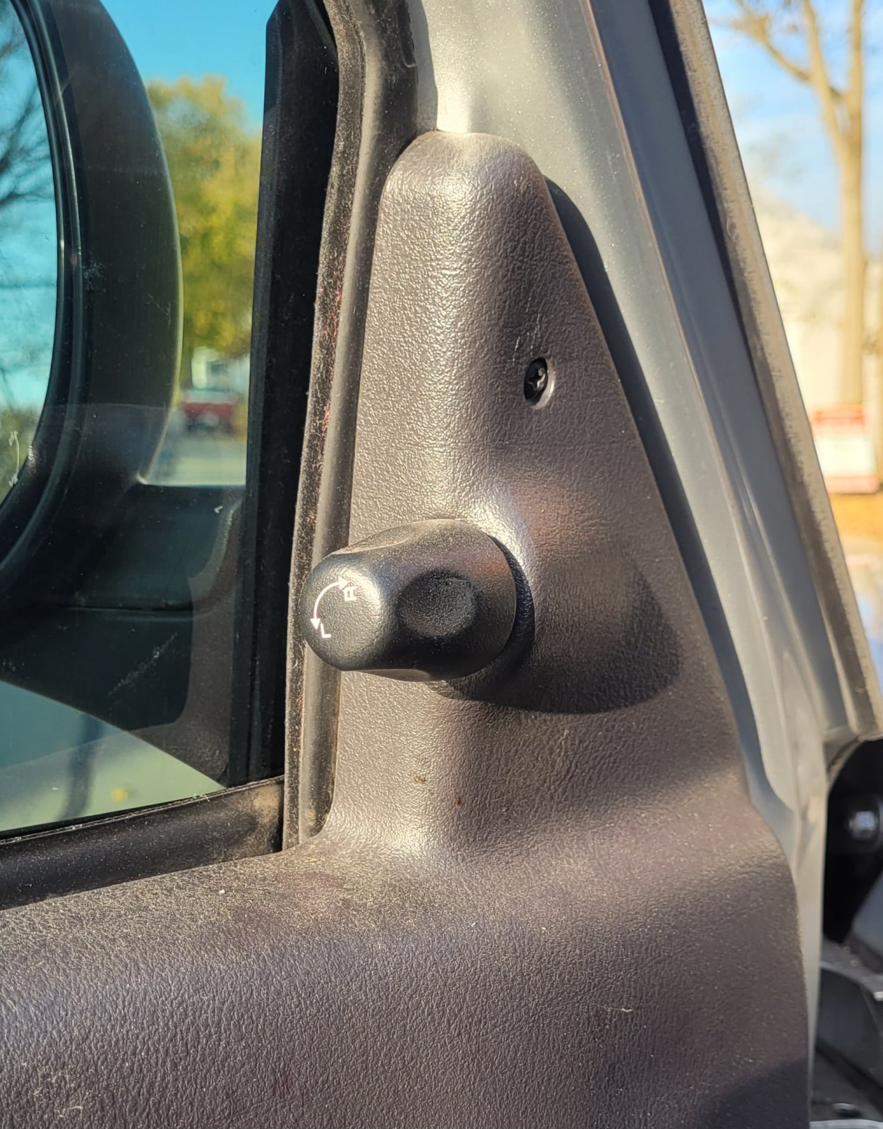

My truck has stock mirrors that are powered and heated now. Attached is the Pic of the control.
No need to check if you have those mirrors......

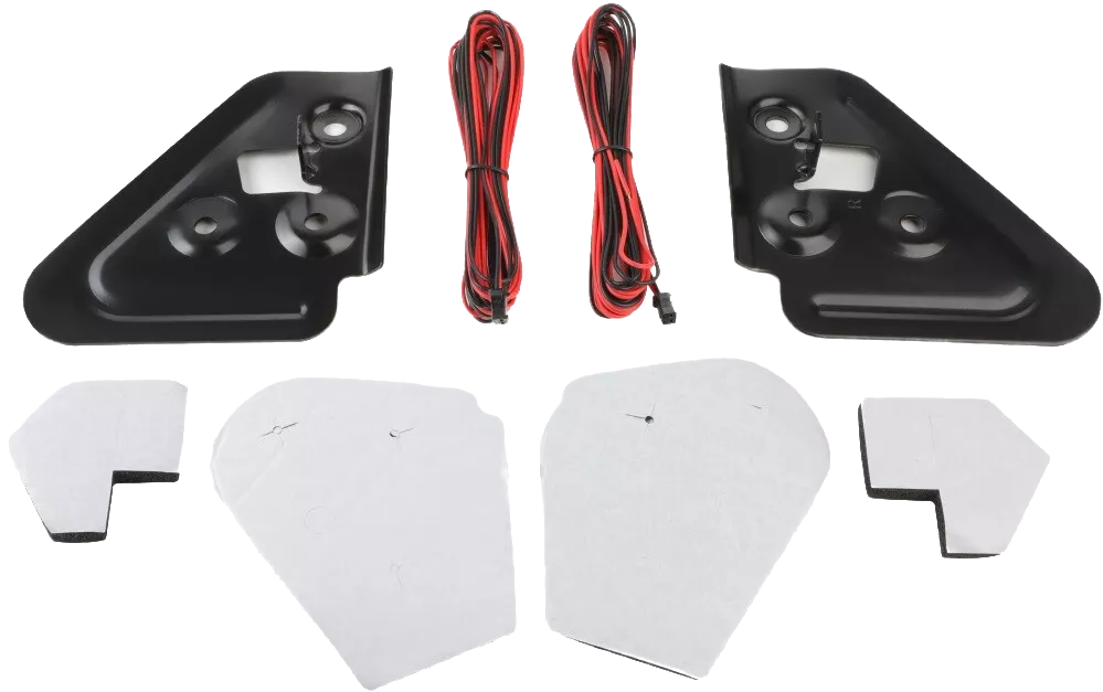

Another thing though, again if I remember right, when a truck got the tow mirror option from the factory, they added a small reinforcement plate to the inside of the door to support the extra weight of the tow mirror. You will need those if they don't come with the new mirrors. They were available through the dealer parts dept back then. If the old TDR threads are still online here, the part number was mentioned in them.
Sam
55156128AB - BR RH Reinforcement Plate
55156129AB - BR LH Reinforcement Plate
This should be right...double check my homework though....
Sam
The aftermarket tow mirrors come generally with the reinforcement plates standard.
Good to see the vendors include them now but that wasn't the case with Kool-Vue when they put them on the market years ago....
Evidently inflation has left them alone as the price today is pretty much what it was twenty years ago.
Sam

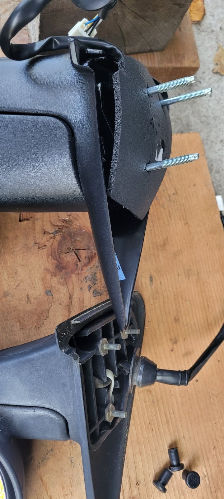

I originally did not have these mirrors, I had the heated power mirrors in the non tow version. I wanted the blind spot mirror and the website said they would fit my truck so I ran with it.
No reinforcement plates with this set.
I started install today and the studs on the mirror I received were way too long and the stud diameter was the next size up..
I would think a 2001 door is a 2001 door regardless of the truck model, is that right or wrong?
Picture is attached.
I'm guessing this is the reinforcement kit?
Not for sale, I found it with a different set of mirrors. No results for the part numbers in my searches.
Yes. I have a ticket in for a non fit product that I made before I found out a reinforcement was needed. I've sent them a Pic of the brackets and a note on the conversation here, but no one has returned my email concerning the problem.
Sorry, Double post...
Yes,. I have a ticket in for a non fit product that I made before I found out a reinforcement was needed. I've sent them a Pic of the brackets and a note on the conversation here, but I'm still waiting on an email. Hopefully they will send a kit when they address the problem and that will be it. The brackets do not appear to be available from the Dodge part numbers or on ebay with the search terms I have used.
