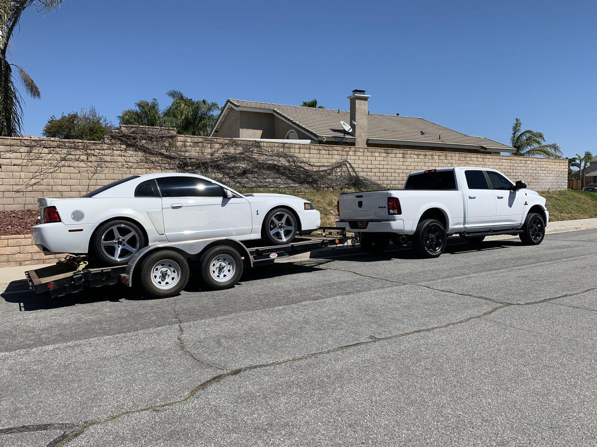

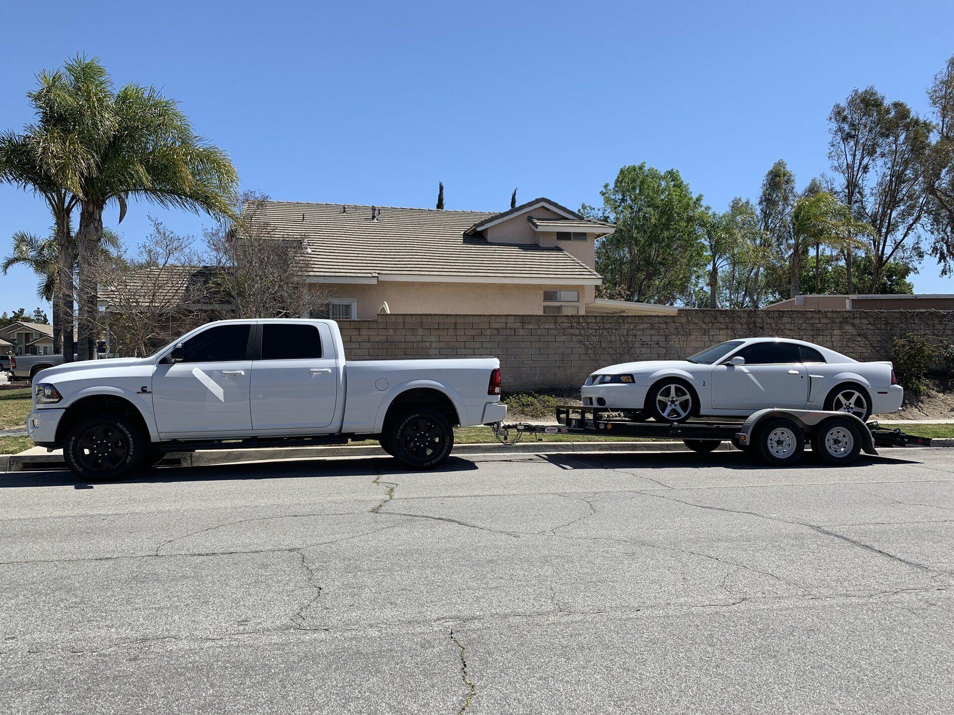

Thank you for all the replies, as soon as I load up I will post a picture, aired tires back up to 80psi last night, just waiting on my buddy to show up.

I'd say you're under 7k lbs. May want to lower your ball mount and level out the trailer.
Earl
Agreed. Approximately 3200 on the Stang and 2500ish on the trailer. No more than 6k on a good day. SAP, your good on towing in 6th except on the grades. I haul stuff like this quite a bit, if the 68 is a glass transmission it must be of some good temper :D

Yes, I would say about 5500 lbs, car and trailer. If you are going to haul, haul big or stay home, JR:D
So towing was 100% successful! I love this truck even more, and yes at about 6k and towing up a hill was absolutely no problem with this Cummins. My old 5.3L Silverado couldn’t get out of its own way let alone haul my car.
As far as the ball mount, I need to purchase a new one, that was the lowest my current one would go.
