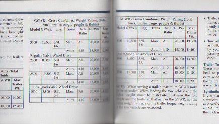

Your 99s GCWR will also change based on gear ratios. It will be in your owners manual. If you don't have one, I can take a picture of the page out of my 98.5 This weekend as they are the same ratings.
I have attached the page below from the owners manual. The only change in GCWR for the 4x4 QC/CC is auto vs manual trans in the 2500. I assumed this was due to the H.O. engine only being available on a manual trans truck in '99. The GCWR for all 3500 trucks was 18000#, regardless of axle ratio or transmission type.
My '06 owners manual specs said the same thing - auto vs manual trans GCWR's were different, only it was reversed when compared to my '99, auto trans was a higher GCWR. Since I sold the truck, I don't have the manual to send the image of the page. I have mistakenly assumed that all the other year trucks did the same, which was an erroneous assumption.
