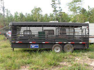

The trailer is about 40 years old and no longer in production. I found the attached image which looks like the exact sane trailer except ours is aluminum colored. It is a gooseneck brand. Looking at this trailer, its hard to believe it's 7500 lbs unloaded. But that's what's stamped on it's rating plate
So just looking at it (and thinking about it), the great thing about the gooseneck is that the lever arm that the truck uses to "lift" the front of the trailer is LONG. The first cow (the one in front) can only get forward about half (or a little more) of the distance between the front axle and the hitch ball, meaning only half (or a little more) of his (her?) weight is being carried by the truck. As the weight moves back toward the front axle of the trailer, a greater and greater percentage of it is carried by the trailer and not the truck. I'd say in addition to the tongue weight of the trailer, you're carrying 60% of the weight of the first animal, 50% of the next, 40% of the next. An animal standing over the front axle puts no weight on the truck and, wait for it...
An animal standing behind the front axle is actually taking weight OFF the truck! Cool...
Sorry for stating the obvious. The math is interesting...
Yeah, these steers are not used to traveling like some horses that travel every month. They are delivered in the fall at about 500 lbs and leave us at 1500- 2000 lbs. In the spring. So they only travel twice in their life. We don't crowd them so they don't injure themselves. Some horses are quite at home in their trailers . But these steers are not. So we will take our time and load the trailer light.
