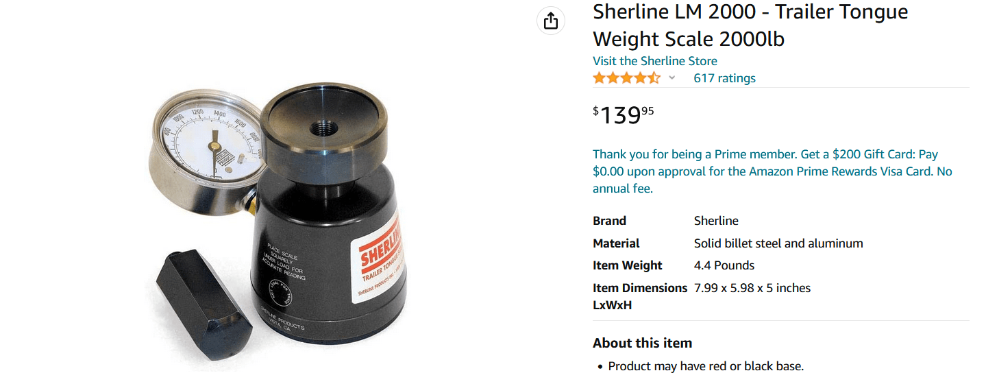

A tonnage gauge (like the one shown in the photo) is a useful tool for measuring exact tongue weight.
