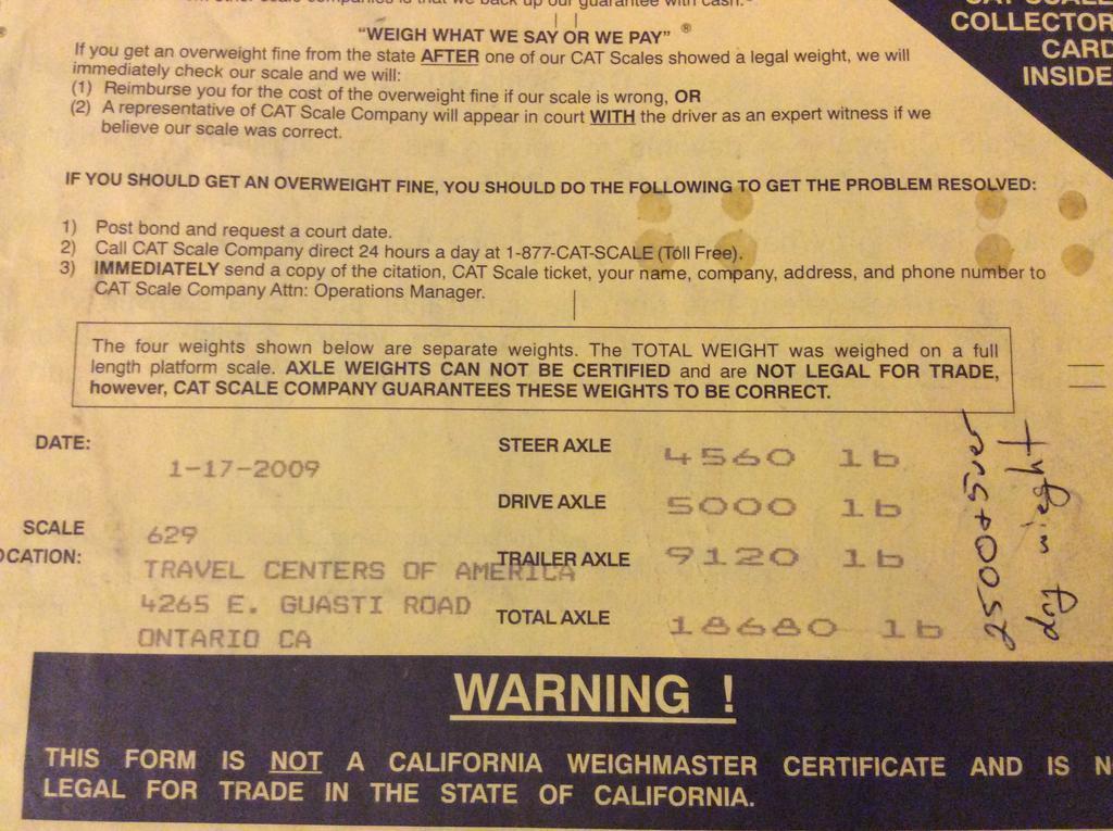

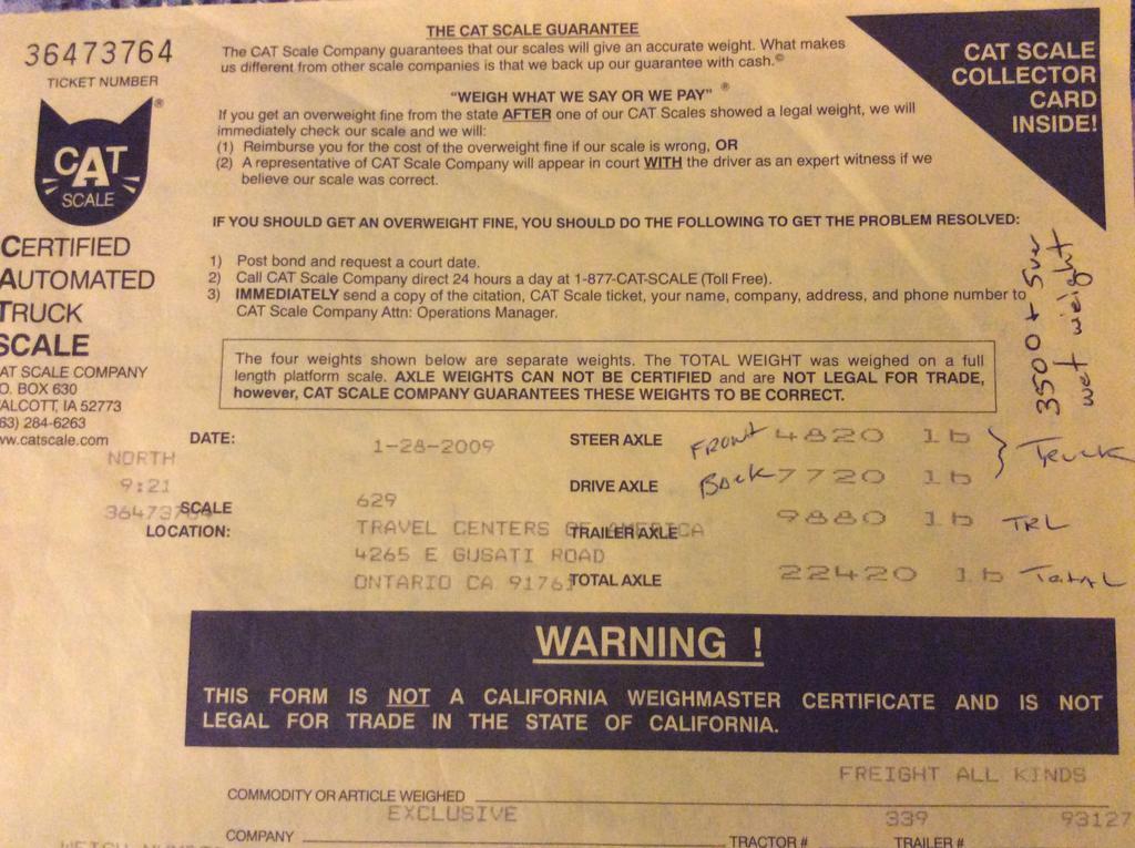

It's asked a lot, and if you would do a search here, you would have many pages to comb through. Look on your door sticker for your GAWR's for the front and rear, those are the numbers you should pay attention to. You can cheat those numbers a little by installing a higher rating tire, per some members here. BUT THE GVWR AND GCWR are bogus, they are Dodges numbers only and are inforced only by Dodge, they can deny warranty if they chose to, but that's it. It's not an accident that those door axle ratings when added together exceed the weight ratings by the same manufacturer that prints the numbers on the same door tag. My 2014 has a 10K GVWR, but when you add the axle ratings it's 11K pounds. As recommended to many members here, weigh the rig and truck together, as close to real weight as you can. A good idea would be to stop at a CAT scale on your trip and weigh your Front Rear and Trailer axles to see what it really weighs. You don't have to get out when weighed, so it'll be true running weights, don't forget to fill the fuel tank before you weigh it. Look at my CAT scale weights with the same 5ver dry and wet weights with my 2500 and 3500. I kept the 5ver dry with a little water for toilet use and propane tanks full when hitched to 2500, and a full water/propane tanks when hitched to 3500. Note the trailer axle weight differences with dry and wet weights, also if you look up the axle ratings for the 2004.5 2500 it's within those ratings. Good luck with you rig, I'm sure you'll be OK, but you need to weigh it to know for sure.

Yes, however as I pointed out when you get correct scale readings, you most likely are gong to be over rear GAWR with a trailer that has a dry pin weight of 2905 lbs.
