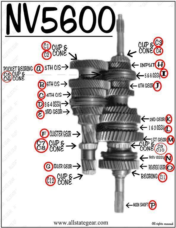

Here is a pic of the NV5600:
Nick
Thanks for the pix of my transmission.
You are welcome, 360# of steel is good stuff:D

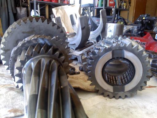

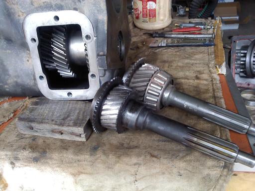

When I rebuild a transmission they usually look like one or both of these pictures, Lol
The first one is a Getrag 360, the second one is an NV4500.
The early NV5600 transmissions had some issues that seems to dog even the updated version. I blame some of the problems on the Dodge engineers (Gasp) for telling the consumers in the operators manual that the Getrag 360 and NV5600 had a lifetime oil fill and changing was not necessary. I also feel the factory oil fill was too light so I use 15x40 in both.
Nick
