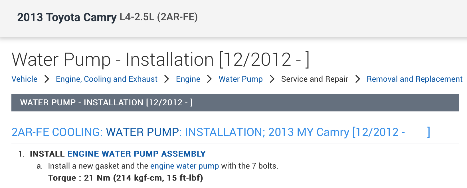

Doesn’t say anything about sealant in the manual. I wouldn’t use any.
No sealer is needed on the type of gasket. It's a crush type gasket the seals with the torque of the fasteners. The torque is very important on that type of gasket! I've used that type of gasket on several types of items, with no issues. :cool:
