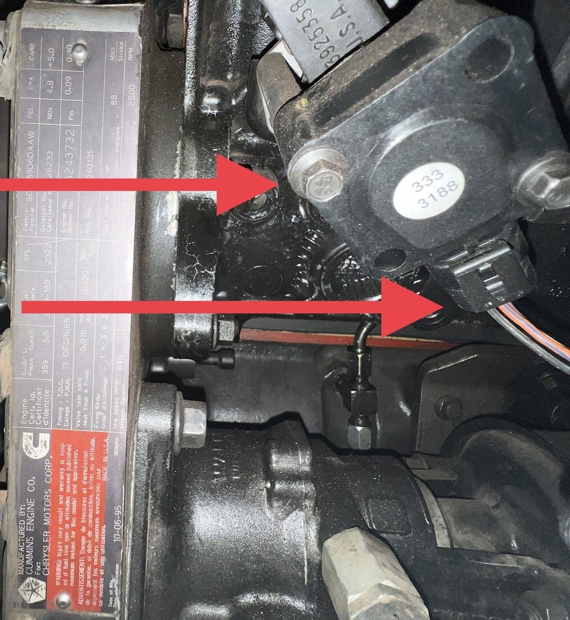

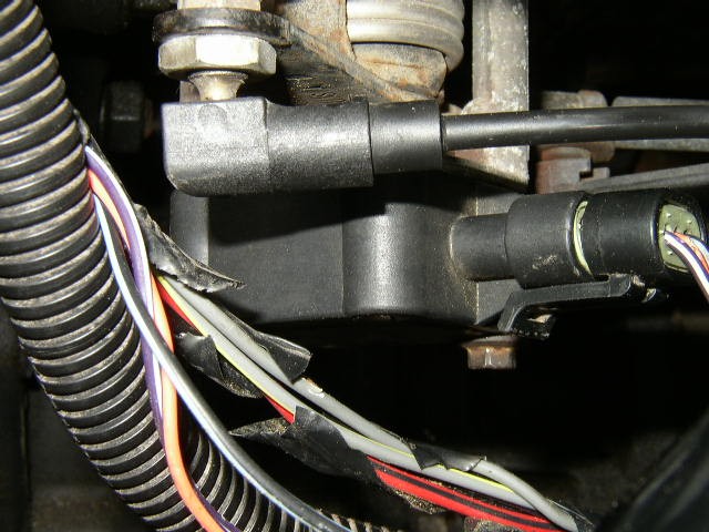

Outside of TPS Delete topic. Would you be aware of any need to adjust or rotate the stock TPS when installing it, or should it simply be attached in the same direction that it was in upon removal. One reason I ask is I have noticed examples of a TPS orientated in different directions. Does it make a difference.
