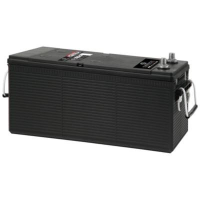

If you have the room I would go with this one. I never liked 6volt batteries and having to deal with the jumper cable. The con is they are heavy.
https://www.napaonline.com/en/searc...eq|asc&Score=0.89&referer=PLP&leftNav=leftNav

I’m with NIssacs. That looks like a 8D size 12V battery. If that’ll go where your pair of 6’s were, I’d do that. No way you’re running that down! Just make sure your cabling is up to snuff.
