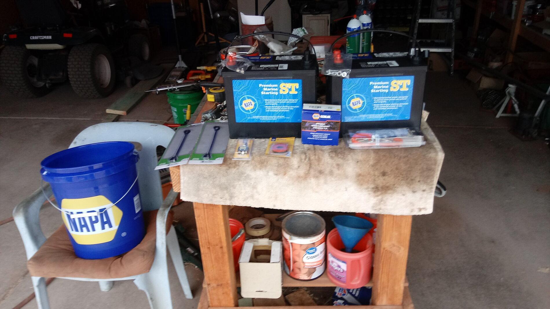

I just replaced the battery in my dump, 2.5 year old Interstate, group 24. It was only 550 cca. I went with Napa, 800 cca/1000ca, one like these, Marine/RV/Starting.
https://www.napaonline.com/en/searc...&Ntk=P_PartNumber&referer=PLP&leftNav=leftNav

I have always used NAPA batteries with great results in my trailer and truck. Why NAPA? I can always find a NAPA Store if required.
