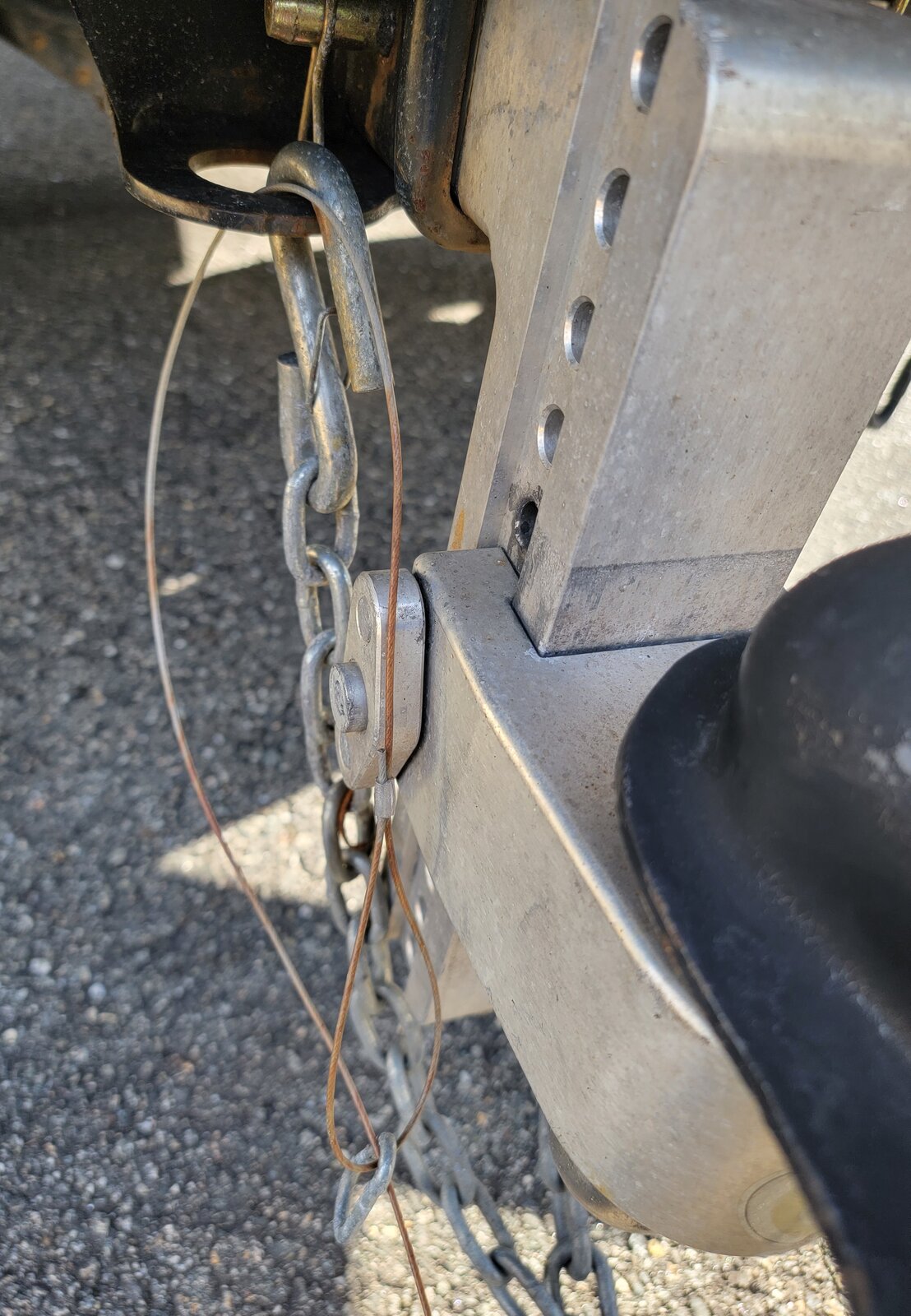

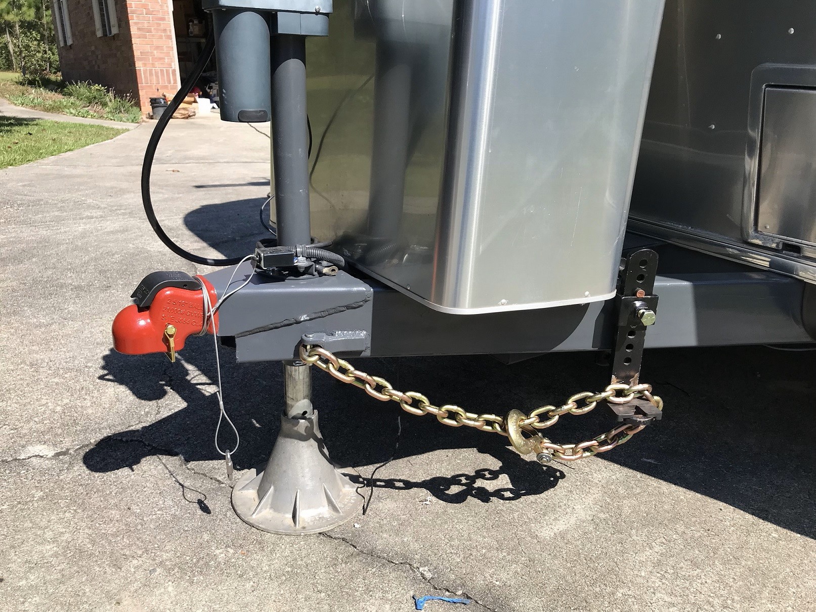

Little Trailer (7k 7x14 Enclosed) I've always just passed thru and clipped it back to its self using the same hole as the safety chain.

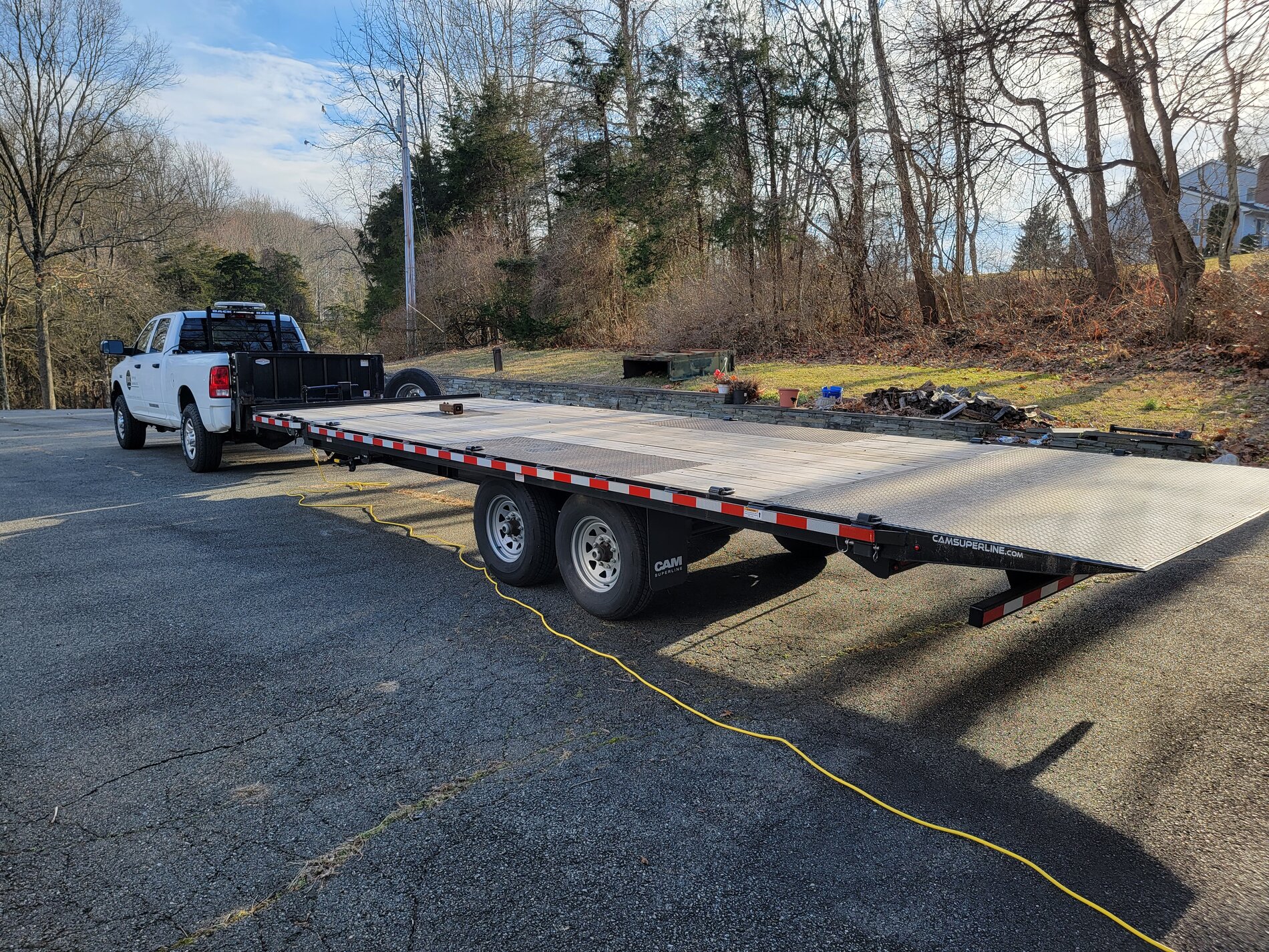

Bigger Trailer (13.8k 24' Deckover)
Has spiral deal, it's a little tight but still plenty of stretch), w
Always just clip to the same chain hole.
