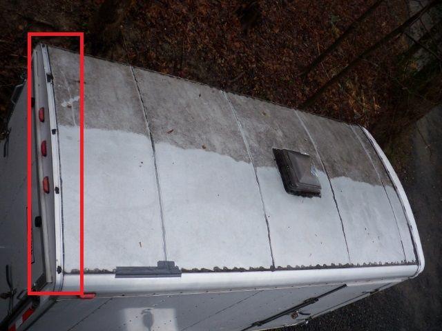

I have a 2003 cargo trailer, and when I was up on the roof replacing the vent lid that the sun had eaten up, I also noticed that the mastic around the vent penetration, and at the edges where the roof meets the sides is beginning to deteriorate, and some of the screw heads are starting to reappear. I have owned this since new, so I know it is OEM and never fooled with. It is a gray material that appears to have been manually applied. Some have said it is actually tape, but it sure looks like it has been spread with a knife or trowel. Can this be touched up in trouble spots, or do I need to remove and start fresh? Any recommendations for materials?

If you are talking about the strip and screw style like I enclosed in the photo then I would put the Dicor self-leveling roof sealer to it....http://www.campingworld.com/shopping/item/dicor-self-leveling-lap-sealant-white/32125
