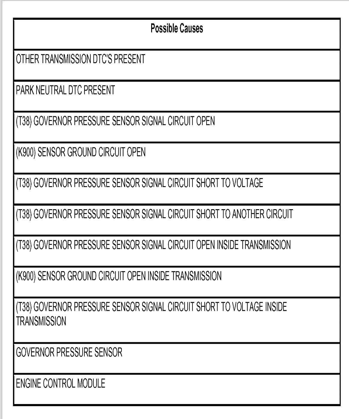

For the 48RE it's listed as: (also the overview) if you remember post up what they find.
P0868-GOVERNOR PRESSURE SENSOR VOLTS TOO HI (DIESEL)
I really have no clue just figured would look that up and see what they list.
Theory of Operation
The Governor Pressure Sensor is used by the ECM to adjust the Governor Pressure to a desired level for shifts in first, second, and third gear. If the ECM detects the monitored sense voltage is greater than or less than a predetermined specification, the ECM will set the desired DTC.
- When Monitored:
Continuously with the ignition on and the engine running.
- Set Condition:
This DTC will set when the monitored sense voltage from the Governor Pressure Sensor is above 4.89 volts for the period of 8.5 seconds
Good luck with your repair. Hope it's just a wiring harness fix or a connector, thats kinda how it lists it when it will not reset. Says to check for stuff like that. But if it does reset there is a bunch of tests and details listed.
Using the schematics as a guide, visually inspect the related wiring harness. Look for any chafed, pierced, pinched, or partially broken wires.
Visually inspect the related wiring harness connectors. Look for broken, bent, pushed out, or corroded terminals.
Wiggle the wiring and connectors while checking for any possible open or shorted circuits.
Check for any Service Information Tune-ups or Technical Service Bulletins that may apply.
