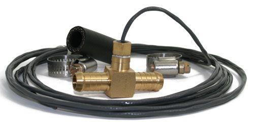

For the transmission temp gauge, my temp sensor is installed in the line from the transmission to the cooler, just behind the bottom of the radiator. It was installed on the truck when I got it but it works and it's easier than welding a bung on the pan. It's a similar setup to this:

Thanks guys for the tips on trans temp gauge. I refuse to use a boost bolt as I just removed a broken one from the intake when I got the truck, I will drill the intake and just make life easy.
I think it was Geno's that had a transmission hose with a crimped inline port. That's what I used for my '06. I just don't trust hose clamps.
If you have all the fittings that were included then you'll just need to drill the intake to size Q, tap it for 1/8npt and install the included fitting. Boost bolt is much simpler but if it's not something you like then that's your other option. For the trans, I bought the 1/2in fuel line tee with 1/8npt sensor hole from genos. On the hot line from the trans there is a rubber portion, I cut it there, and installed the fitting. The sensor wire is just a single 18ga wire that runs from sensor to gauge. You'll also need to run a ground wire from the sensor body (not the sensor mount stud) to a ground of your choice.
