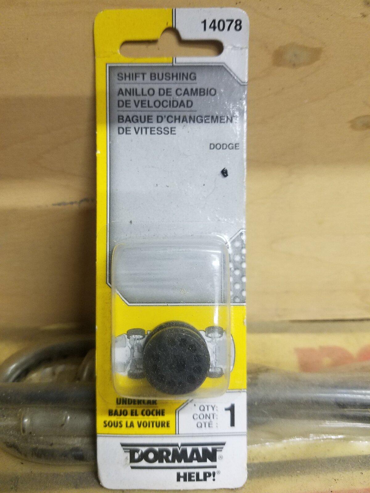

Well, my linkage rod popped out of the case arm. A quick search on Rock Auto shows a Dorman bushing, #14078 as a replacement. However, there’s some conflicting info in its description involving a cable, etc. the application chart seems to encourage its the right item.
Has anyone had this happen, and what did you use as a replacement?

That's the correct part... had two disintigrate on the 03 Ram 2500 and one on the 4500.
I still have one as a spare.
Easy to replace.
Cheers, Ron

Hi Wayne M. I replaced mine recently, no cable that I'm aware of. Purchase two of the above item from local auto parts. I purchased the first from dealer at more than twice the price of the second from auto parts after I realized it too needed replacement.
