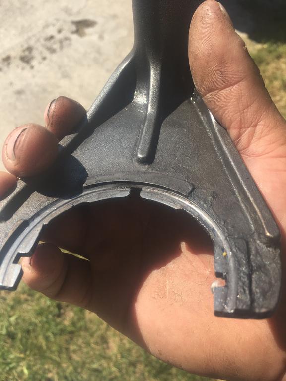

Well I found the problem seems the good ol reputable shop dropped the ball again the shift fork pads were gone because the shift sleeve was seized to the shaft so I replaced the collar and the shift fork fixed the popping and clanging and banging what do these guys do tear it down far enough to throw a bearing and seal kit in it yip it's rebuilt . Oh you mean it's still got the problem well we rebuilt it there's nothing more we can do
The fork shows wear from missing pads
