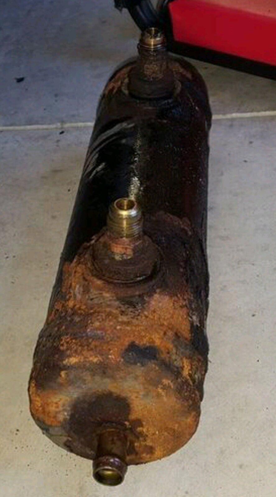

Unless it looks like mine before they started. Mine was just a typical NE truck with years of salt damage. Then cant really blame them.

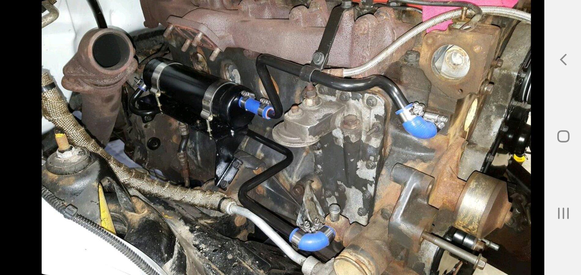

I basically redid the whole system with a mix of Cummins parts, Mr Bob's Hoses, New Brackets, Hardware, and trans fluid coolant. heater. Cummins wanted like $1,500 or more for that thing for my 96 anyway.

I would bypass both the trans part and coolant part if it looked like mine. It's in a really bad spot on my 96.
Unless you are living in Canada, AK or other super cold place you can delete the whole heat exchanger and not have to deal with it. FullSendDiesel.com offers a braided line kit to delete it bypassing so the transmission fluid goes straight to the cooler on the front of the truck, bypass the cabin heat fittings below the oil filter. It's somewhat pricey but they make a super quality product and will customize it for whatever you want. I did mine about a year ago and have had no issues since. I live near Lake Tahoe so get some cold winters here and no issues in the summer either. Very glad I did it and no more worrying about coolant getting in my transmission or vise versa.
Unless you live in Canada, AK or other super cold location you can just delete the whole heat exchanger unit. FullSendDiesel.com sells a kit of braided lines that bypasses it and the transmission fluid goes straight to and from the cooler on the front of the truck. I think the nylon braided kit is probably a little cheaper then replacing the exchanger. I comes with lines that delete the fittings and other connections below the oil cooler and go straight to the heater core in the cabin. I live near Lake Tahoe and get some cold winters here and also driven and towed with it in the summer w/o any issues. No more worrying about coolant leaking into my transmission fluid or vise versa as the exchanger ages.
I'll also add that deleting the heat exchanger and going with the straight braided lines will also remove the check ball in the flexible line that prevents drain back of the torque converter. The check ball can be problematic and stick not allowing fluid to get to the front cooler. Many people in the early years of the 2nd gens being sold would delete or drill out that check ball to insure the full flow of fluid. Two negatives to this 1) on first startup it takes a minute to allow the TC to fill (in over 20 years never been a problem) and 2) the dipstick will show over fill when the truck sits and cools completely down. To get a accurate measure of transmission fluid have to fully warm up and have it in neutral. Neither one of these 'negatives' have ever been issue for me in over 180,000 miles and half of that towing.

Yeah mine was seeping externally, no issues internally mixing. All my hard lines were in the same shape really bad rusted out, really looked like they could fail. Hoses were all brittle.
NE trucks just get their butts kicked with salt and brine. Mine actually has a whole different frame due to rust.

Since my second oil change almost 22 years ago and after my first trans rebuild 15 years ago I've used Blackstone Labs for oil analysis and they advised me they have seen incidence of coolant in the trans fluid. I've benefited from their expert advise before in spotting diesel in my oil from a leaking injector and it saved me big time. If they say it has happened was good enough for me. They see a lot more cases. Additionally, I'm one that if I need to replace a component I'd perfer to upgrade and make it better/simpler going forward. Also, Thoroughbreed Diesel on anything newer then the 2nd gens, when you add lets say the coolant bypass kit advises to delete the exchanger also. It's really a unnecessary item that was provided solely to address applications in extreme cold conditions. Considering the cost of a new exchanger, lines, etc and having mechanics wrench on that weak link of a fitting, verses any delete kit it's a no brainer to me. I'[m real happy I went the FullSendDiesel way. Kevin was a great guy to work with. I asked for a custom fitting for a temp probe and he did it for just a few dollars more.
