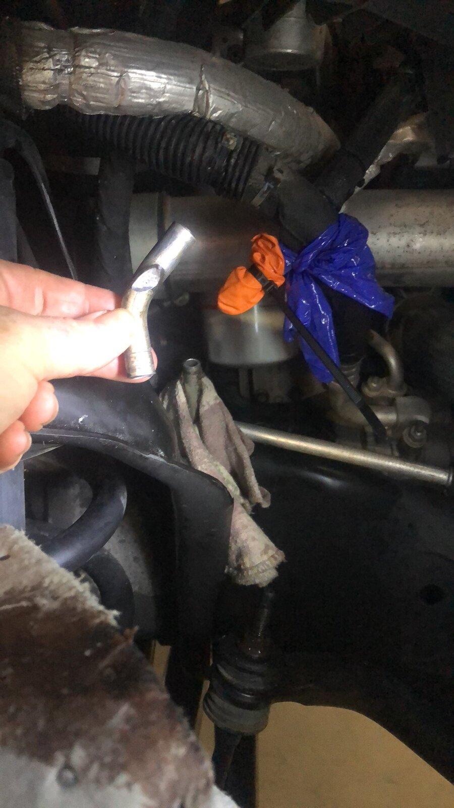

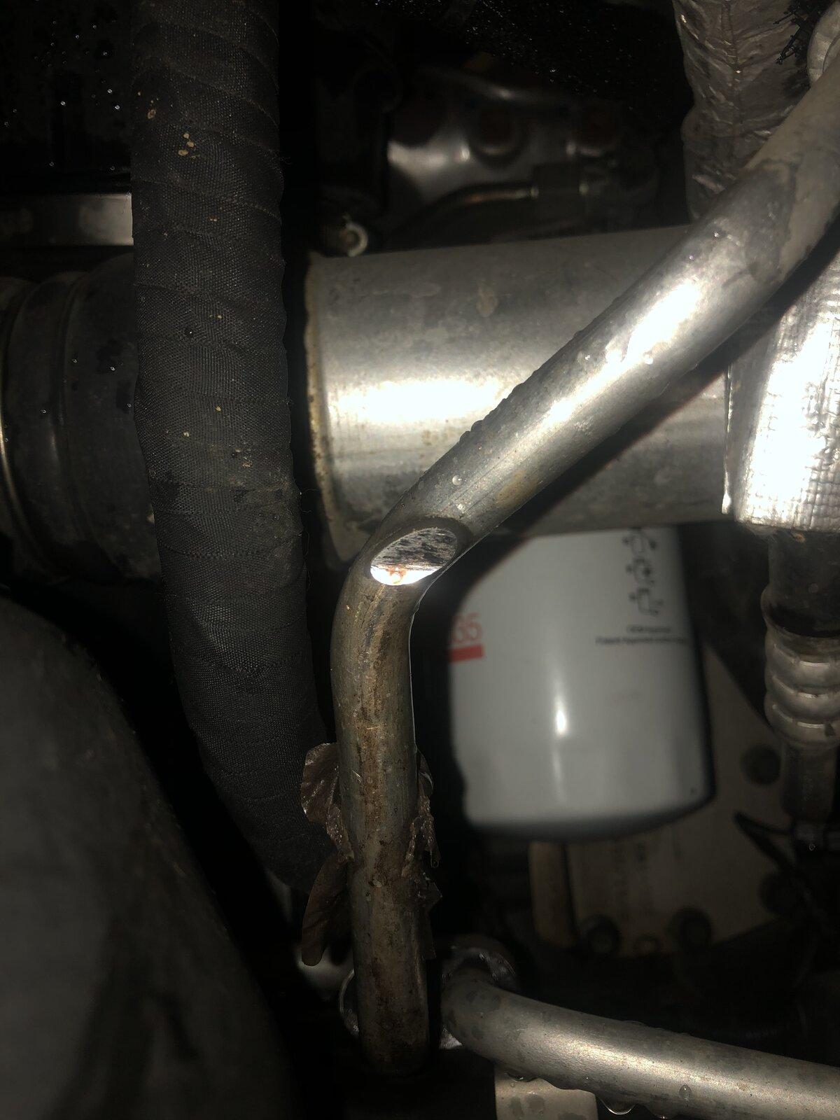

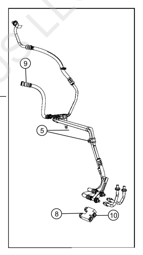

Somehow I missed that my fender liner was rubbing against a transmission cooler line. Rubbed a hole in mine & was leaking. As a temporary fix, I cut the damaged section out & used some transmission cooler line & clamps to get me by. I'd like a more permanent fix than this, but I also don't want to spend the $600 for the complete assembly. Anyone have any good suggestions for a good reliable permanent fix?
Thanks
Well, my redneck mind came up right quick with three options:
  • Braze/solder it up (Too late...)
  • Epoxy (Too late...)
  • Find one in a salvage yard, cut part of it out, and use brass compression unions
Agreed...flare or barb of some type. I fixed a line the same way on my old Ramcharger (just a hose), hose clamps were tight and I checked them occasionally. It still eventually popped off. I then put flares on each tube and put the hose back on, worked fine after that.
