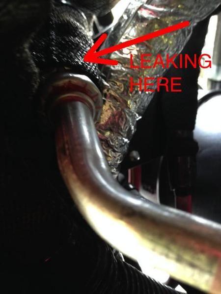

UPDATE: I got the braided cover loose and pulled upward on the line. There is indeed a flexible rubber section underneath in the line with crimped connections on each end. The leak is coming from around the lower crimp and the rubber line. I'm not sure what changed, but now it's leaking a constant stream of transmission fluid while the truck is running. Just my luck! Obviously the line is under constant pressure. I sure hate driving it this way, but I've got to get it to the dealer tomorrow to get the ball rolling at replacing the line under warranty. I've checked the transmission fluid level, and while it's a little low, it's nowhere near the "add" mark yet on the dipstick. I have a quart of Aisin ASRC ATF to top it up as needed.

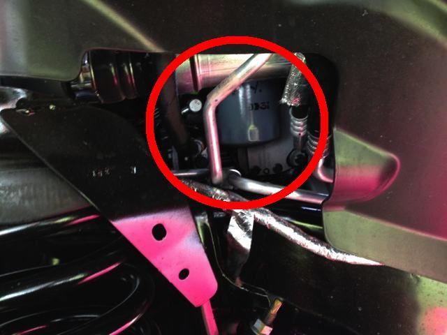

The line as seen through the cutout in the right wheel splashguard:

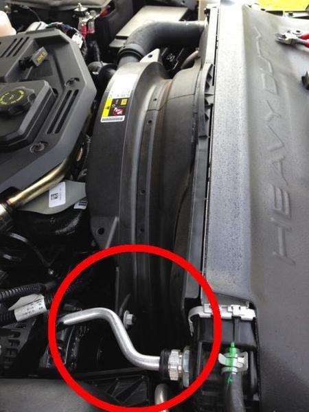

The top of the line where it goes into the radiator. It's NOT leaking here:
