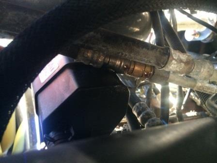

Second, while under the truck I noticed the front driver side frame horn was wet, and found this: I'm questioning if the brass colored fitting is factory, because I don't see a similar fitting on the other line? I am guessing these are the push connect type fittings. If I can determine if that's a factory fitting I think I will just replace the line and service the transmission all at once. Could it be an inline check valve or something like that?

The brass fitting is the check valve. It could have been drilled out, and put back in place. The best thing to do with your situation is to splice in a fitting and a new section of hose where it is. First to solve the leak, second it would be a great area to service the fluid from.
The brass fitting that is leaking contains the drain back ckeck ball or a place for it. It is just a union so it may be loose and causing the leak.
