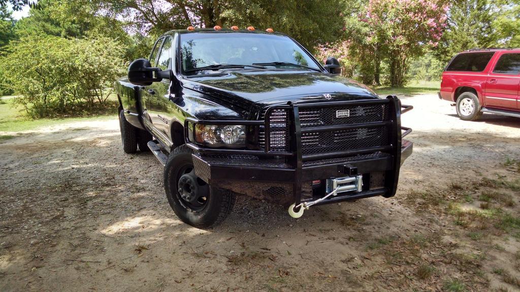

I have a rebuilt 48re automatic that overheats during in town driving only. In town it can hit 220+ degrees internal temp and 190 degrees pan temp. Highway or over 45mph runs about 160 degrees internal and 150 degrees pan temp. Outside temps have no effect, same happens from 100 degrees down to 40 degree outside temp. Trans shifts fine except from 1st gear, if I pull the shifter into 1st it feels like the transmissions shifts but rpms stay the same. Transmission has upgraded clutch packs, shift kit and billet internals, triple lock converter and a bd deep cooling trans pan. Also per trans rebuilder I have removed the transmission/coolant cooler and use only front transmission cooler. Infrared probe shows front cooler working. transmission was rebuilt before I did the motor so the 1st gear shift didn't really show. Any one have some any ideas what I should look for?

Sounds perfectly normal. It is not unusual to see 220 or thereabouts in stop and go driving without any air flow. With the heat exchanger removed it will be even warmer. All you can do is hook the heat exchnager back into the system or add a thermo activated aux cooler for those conditions.
I am taking it in today for the rebuilder to check it out, the 1st gear issue worries me and its under warranty. as for the aux cooler I like the idea, where would a good place to fine one? these trucks use 1/2 lines so off the shelf is not option. As for reinstalling the oem coolant system, not a chance, seen too many failures. Seems like a bad start since I have yet to tow with the new trans with a heavy load.

Just got done talking with the rebuilder, they are boring the valve body to deal with some wear issues. guess there was some fluid getting by causing the trans to shift wrong with a light foot. 30% or more throttle it worked fine. The owner of the shop has been dealing with my truck himself, he is impressed with how it runs and has asked me for a build list for his truck. I tend to drive it like I have an egg under my foot until I see a ford or rice burner. The rebuilder also wants me to add a aux cooler and restrict fluid a little, sounds weird but they are saying fluid is moving too fast to cool correctly without having the oem cooler.

Thanks for all the information, I got the truck back last night and got stuck in Greenville SC rush hour for a little over an hour with the highest trans was 196 degrees. Transmission shifts great and no other problems. The rebuilder had to bore out the valve body due to wear, some of the valving was leaking. I still plan adding an aux cooler later when I have more time and money. Next project regear to 3:73, and ideas?
