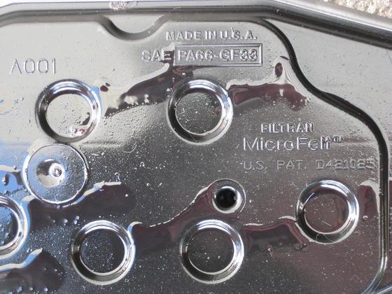

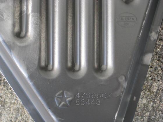

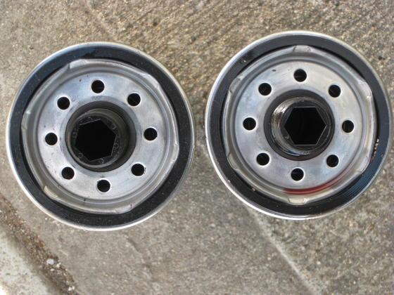

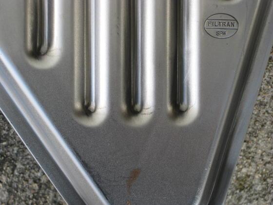

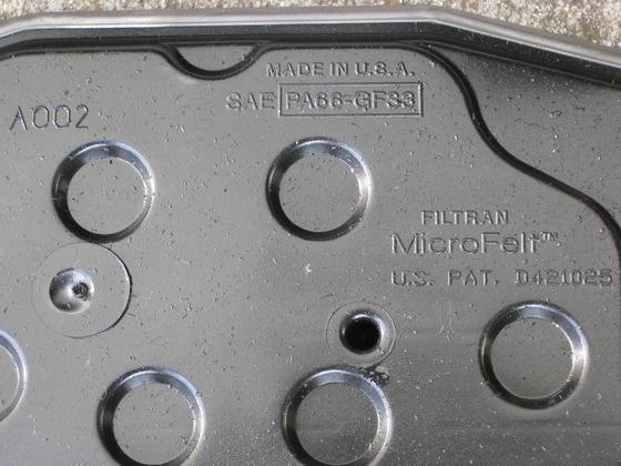

I still had the old filters (Hastings and Chrysler)from changing transmission fluid in both our Jeep Grand Cherokee and the 09 Dodge pickup this fall. They take the same filters which is convenient for the parts counter and diy folks.
The first pictures are of the pan filters. Notice the part numbers are the same and both have "Filtran" stamped on the topside. Apparently both are manufactured by Filtran. There were no distinct markings on the spin-on filters but were visually identical except for the chrysler ink stamp.

The transmission filters do look the same. It appears that even Hastings doesn't make their own filters.
I guess it's hard to know who manufactured any products now. Filtran filters may be made in China and packaged as Filtan, Hastings, and MOPAR.
They say made in the USA right on them..... I bet filtran manufactures them for many other oem's and aftermarket names. Check their website.

Products are copied all the time,especially off shore where patents are ignored,because they look alike on the outside does not mean they are the same
