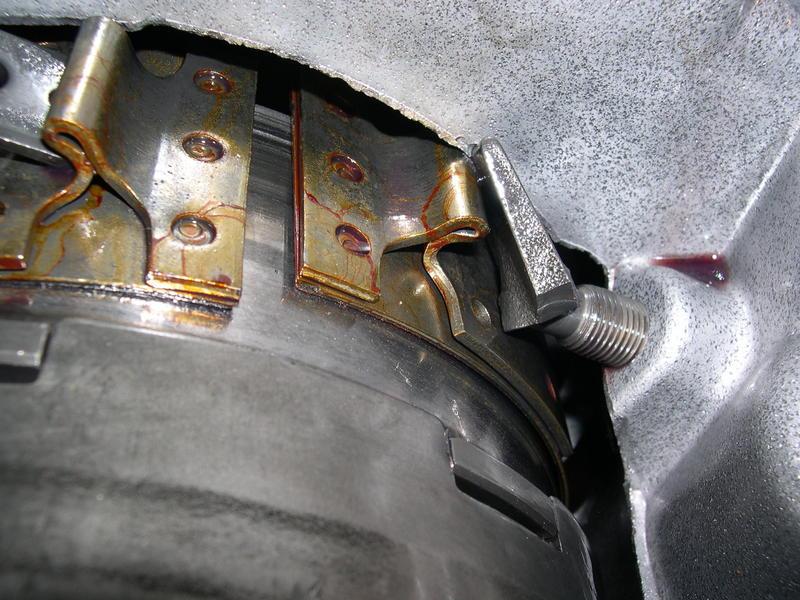

I recently had a 1-2 shift problem (see picture). It shows the band apply wedge out of place and binding the front drum. I think the problem started with the governor solenoid. Now I'm doing a complete rebuild.
More likely the band anchor broke a side out of the pocket where the adjuster screw sits and then they get pushed out of alignment.
Yes, the "pocket" where the adjuster screw fits is broken out on two sides but not visible in the photo. But before that I got some "hunting" between 1st and 2nd at slow speed, causing me to think the govoner solenoid was chattering. The 47 RE lasted just under 200,000 miles without repair and appears in good condition except for the band and wedge.
That is the typical failure. One of the first things to do is get a billet anchor and band strut to address the weakness issues. Between the anchor wanting to break, the strut wanting to bend, and the flex band stretching it is a wonder it works as well as it does.
