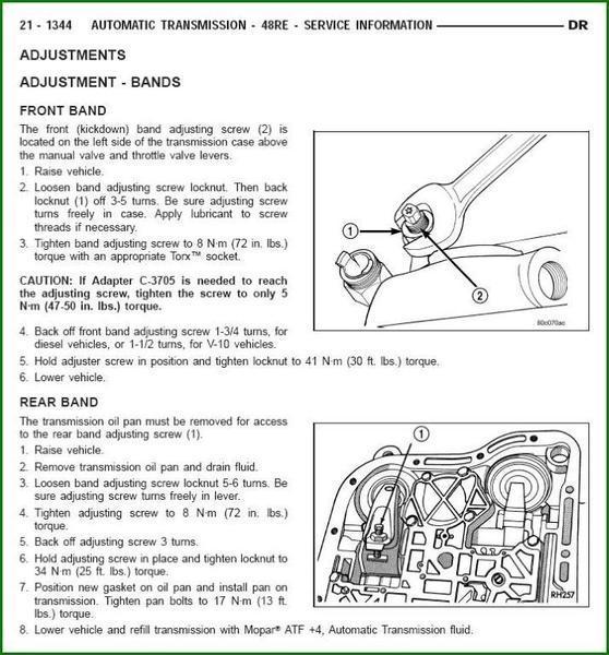

Adjust your front band. Jess

Ok so now I am not to happy, I took it to the transmission shop had fluids and filter changed and both bands adjusted which they said were both way out of adjustment and it is still shifting down hard when I come to a stop down to 1st gear but now seems to be worse so now I am stuck they did say it could be a shift sylinoid or something like which is under the pan and then there was something else on the outside of the transmission, but no codes and I am getting very frustrated, any help would be great. Thanks
