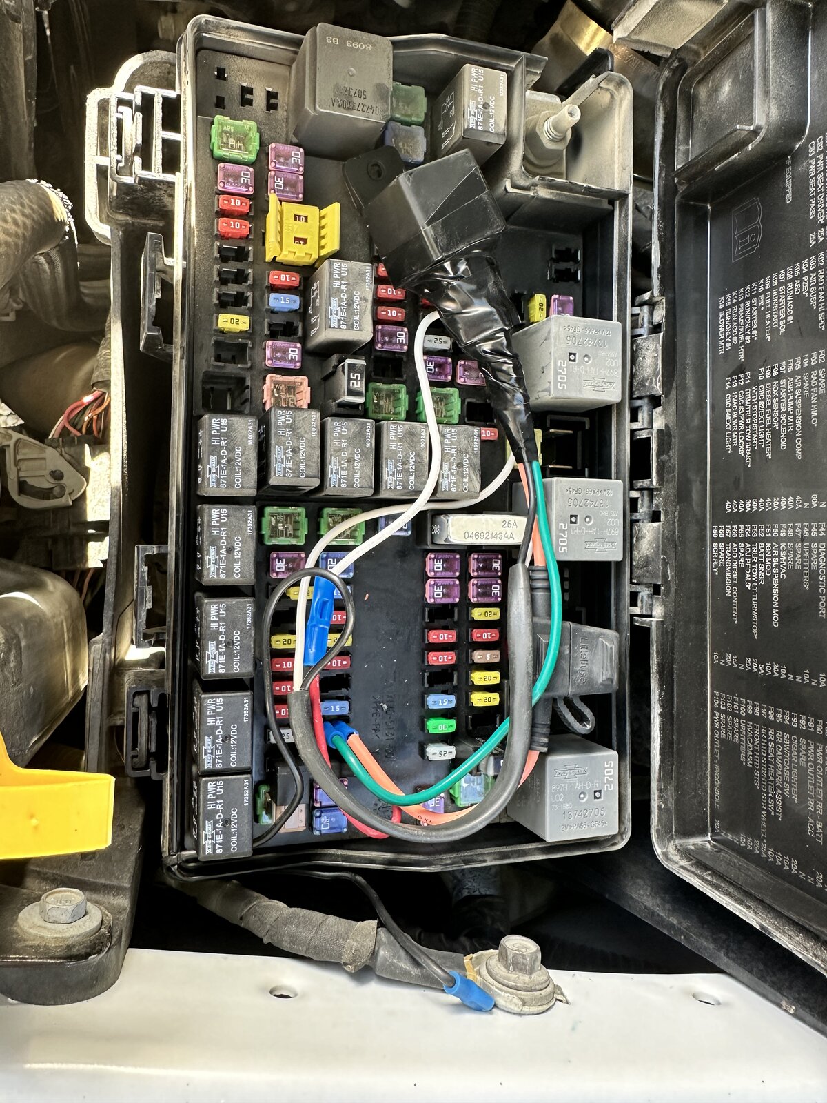

When I recently mounted our truck camper (2003 Bigfoot 1500) I plugged in the 7 pin wiring plug from the camper to the truck bed and started the refrigerator on propane since we were heading out for a little shakedown trip the next day. When I went to start the truck the next day, the truck batteries were dead, reading about 6 v. It seems as though the camper is drawing off of the truck batteries and not using the house batteries.
1. Seems odd that it took less than 24 hours for the truck batteries to die, since I was only running the fridge.
I contacted a mobile RV repair service I've used in the past (mixed results but they're convenient and supposedly very knowledgeable about 12v wiring). They set it up to now be isolated and so that the truck charges the camper batteries via a DC to DC charger. They assured me that the camper will not draw power from the truck batteries.
2. Take a look at the wiring job and tell me if you'd be happy with this. I can't help but think there's a cleaner and more professional looking way to do this.

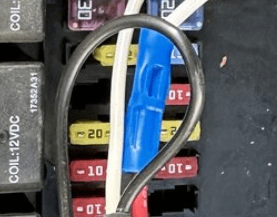

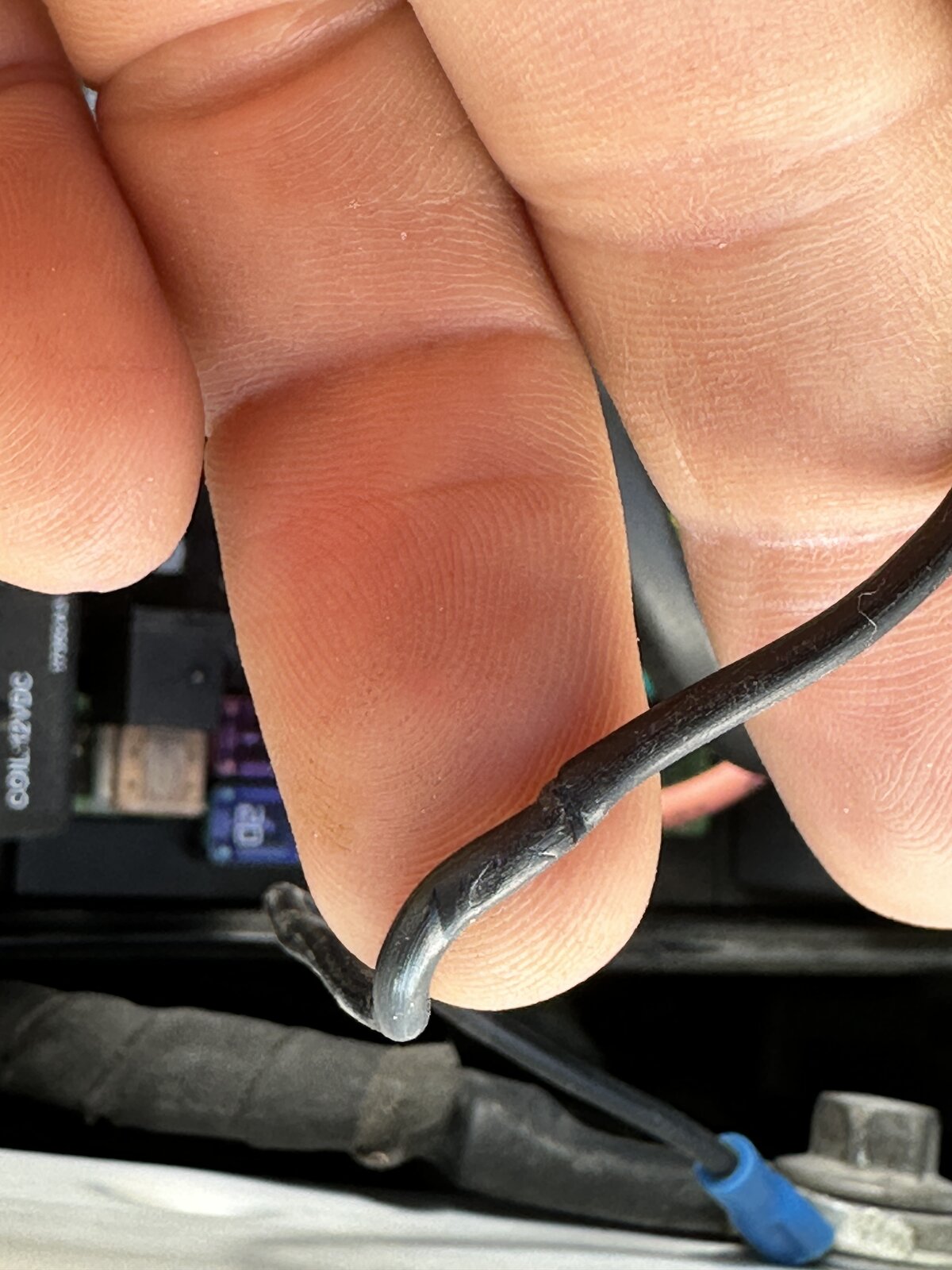

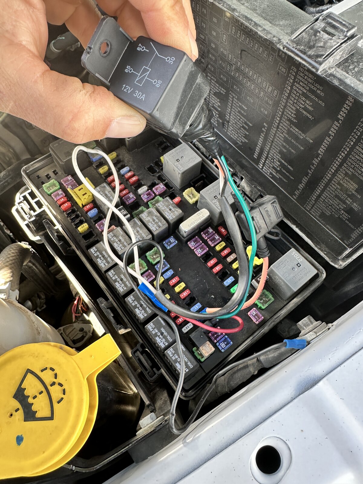

There's way better ways to do that! The crimped ground wire will chaff through after the first trip with being pinched under the lid! There are plenty of Ignition hot wire to activate the relay for the charging system. The use of an unsealed butt connector and the electrical tape wrap are a tell tale that there is no pride, just get it done! Very easy to assemble a harness, and mount the relay to a fixed point versus floating around in the fuse box. Hope the bill wasn't to bad. Good luck with the shake down trip.

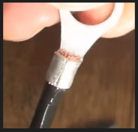

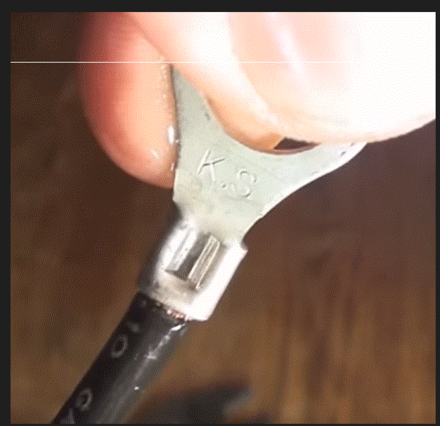

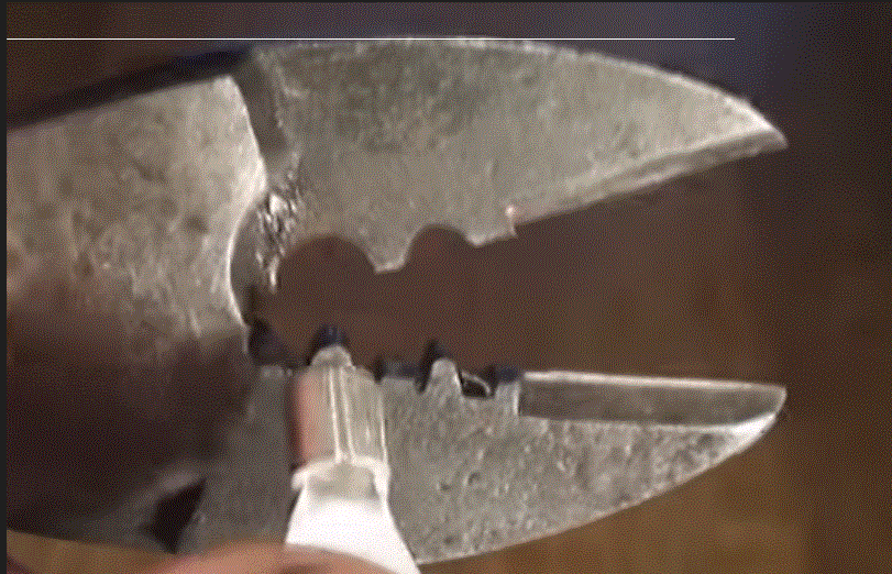

The crimping tool used in your edited photo below is a good crimping tool, but in this case the tool was used in a wrong application. This tool is designed for use with a non-insulated crimp connectors.
The following photos show what a non-insulated crimp should look like. Note that the seam in the connector is contained in the saddle of the crimping tool.
The connection should be covered using heat shrink with a sealer.

Instead of modification of the truck it would be smarter to modify the Camper that it doesn't pull power from the truck with the engine off..
With the B-2-B charger* that is accomplished as they sense the higher voltage with the Alternator charging and switch off as soon as the engine is off again.
So, the hack in the fuse box is actually useless in my eyes.
*given correctly installed!
Thanks for the feedback everyone. I'm now tasked with telling the mobile rv guys the work is of poor quality AND finding someone to redo it all correctly. Not sure where to look for that...
