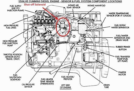

The shutdown solenoid is mounted on the injection pump. Should be pulled in, in the start/run position. Check your fuses and relays in the PDC under the hood.

Second, check the shut-off solenoid.
It pulls the shut-off lever UP. Attempt to start it, and leave the key in the on position. Get out and see if the lever is UP. If not, push it up and see if it stays. If so, it's probably the relay.
