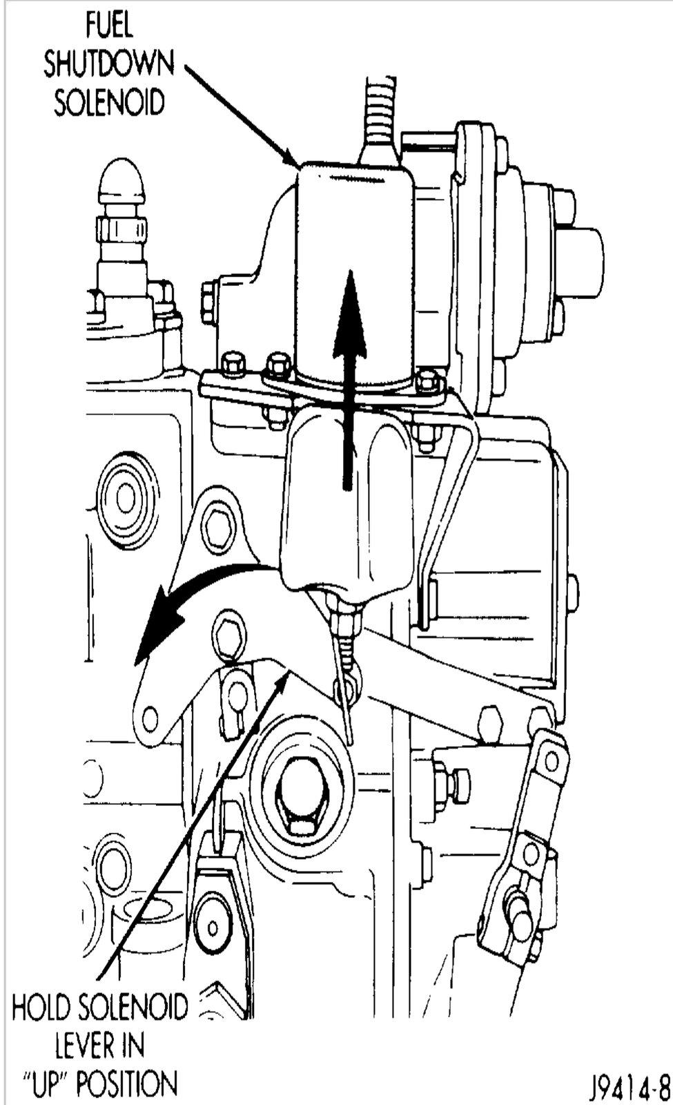

Usually my truck starts right up and runs great, no problems. But occasionally it will start, run a second or 2 and then die. I've been able to get it started so it didn't leave me stranded by trying several times to start and then give it half pedal. It runs rough for a few seconds and clears. No white smoke, no loss of power when it's running.
Any suggestions?

The boot deal on the Fuel Shut Off solenoid might not be allowing it to pull up fully on the first try. The boot can come off most of the times.

Fuel shut off was replaced several years ago and the boot is in good condition.
Found that "Engine dies at idle (Especially when hot)" under the Low Fuel Pressure trouble shooting steps. Kinda a long post.....

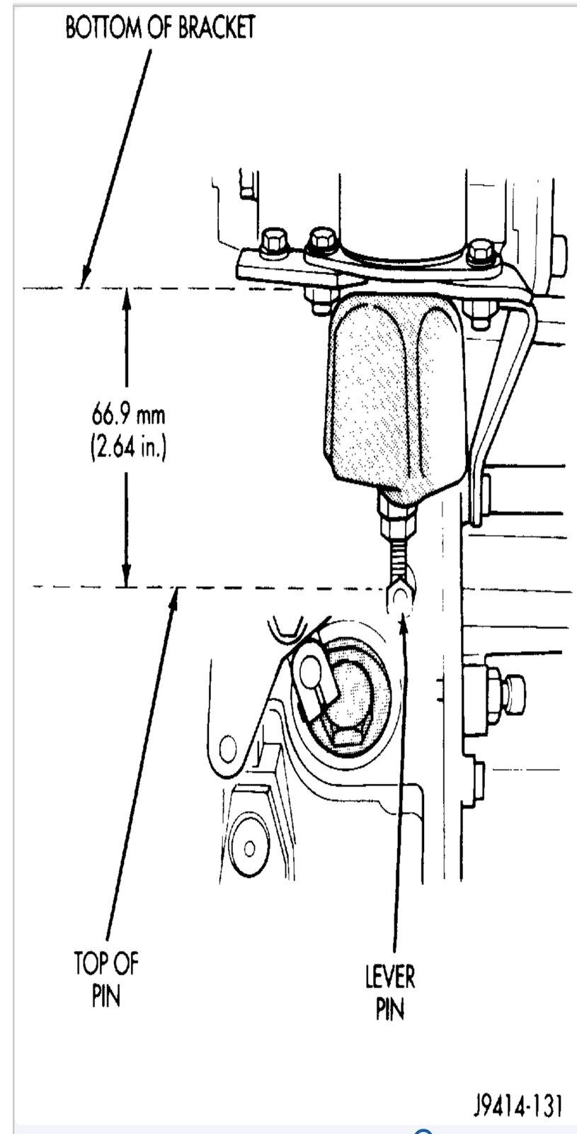

Just in case, I know you said this was replaced.
NOTE: After replacing the fuel shutdown solenoid, the solenoid shaft length must be checked and if necessary, adjusted.
SOLENOID SHAFT ADJUSTMENT
1. Turn the ignition switch ON.
2. Pull up (by hand) and hold on the solenoid lever. If the solenoid is operating correctly, it should remain in the UP position with the key in the ON position.
3. Take a measurement from the bottom of the solenoid mounting bracket to the top of the injection pump shutdown lever pin.
4. Dimension should be 66.9 mm (2.64 inches).
5. If adjustment is necessary, loosen the shaft locknut and rotate the adjustment nut to attain dimension.
