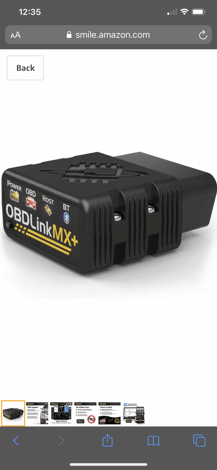

Do I need one of these to go with the Alphaobd?
I have the one you listed. You can save a few bucks and get the original MX if you only intend to use it on your truck or other equal year and older vehicles. The MX can link to other vehicles up to a certain model year. The MX + covers up to current model years and a new vehicle is in our future so I opted for the MX+.

Just to be clear, the Alpha app is for FCA vehicles only. The OBD MX/MX+ has it's own app and can connect to multiple vehicle manufacturers including our trucks, but is more of a general diagnostic tool. The Alpha app connects to the truck using the OBD dongle and allows you to connect to the truck and command vehicle specific functions like stationary desoot, changing high idle speed, turbo actuator calibration, tpms adjustments, etc.
I would get the + for possible newer vehicles. Found out the Alfaobd is not compatible with windows on my wife’s hp laptop. Not sure what to do.
