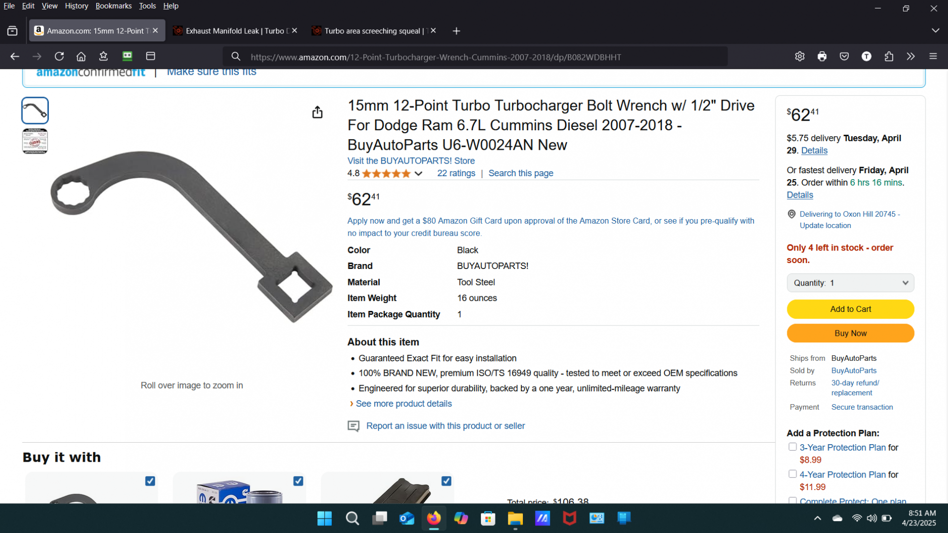

Thanks for the info. Turbo wrenches? Are you talking exhaust manifold to turbo?
At a glance I assumed the cooler needed to be removed to get at the manifold bolts. Fender liner removal is needed I assume?
I had to lookup a turbo wrench myself. It's appears as if they are "S" wrenches. Tools that I have, but rarely use, but come in handy for tight spots.
@Cummins12V98, Yes, the turbo to exhaust manifold wrenches;
