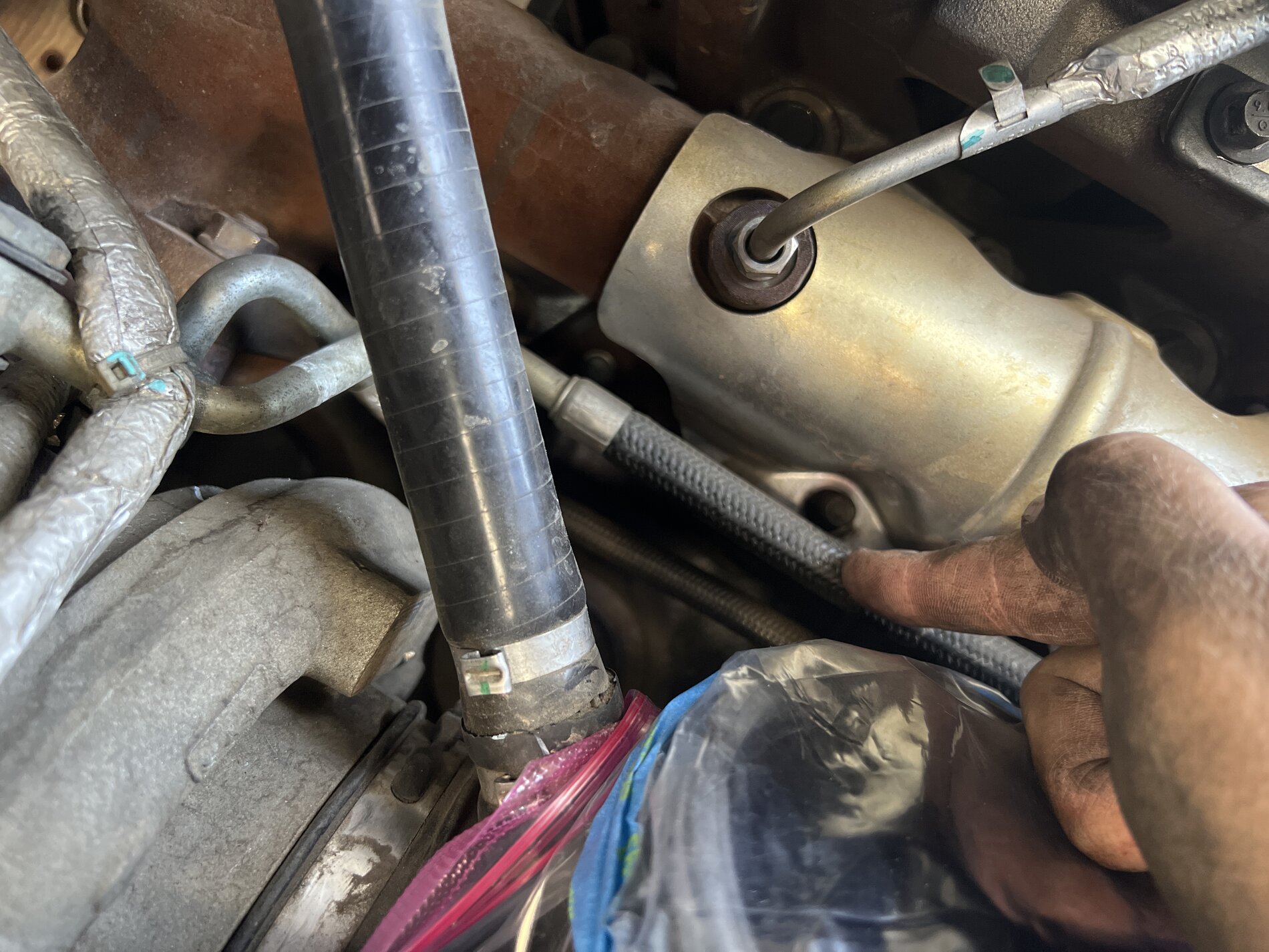

I bought the city diesel actuator and I’m getting ready to do this. But I am not able to identify exactly which coolant lines. I should use the clamps on. The hose that I’m pointing to goes from the turbo to a coolant why that is above the oil filter. Is this one of the ones I am supposed to clamp? The flexible section looks like steel braided hose. I’m assuming there is a second line but I have not yet found it.
I ended up bringing the coolant from the lower radiator hose behind the right side there. I was able to pull the hose and drain right into a funnel using five one gallon containers with no issue. So my question now is how long after installing the city diesel actuator will it take for permanent code P003A to go away? I have to get this damn thing smog checked as soon as possible. Also, what is the max boost? I should expect to see on a 2016 6.7 L? After installing the new actuator I was able to get 24 pounds of boost. I never really paid attention at this point thank you in advance.
