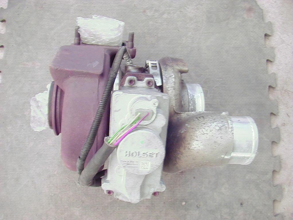

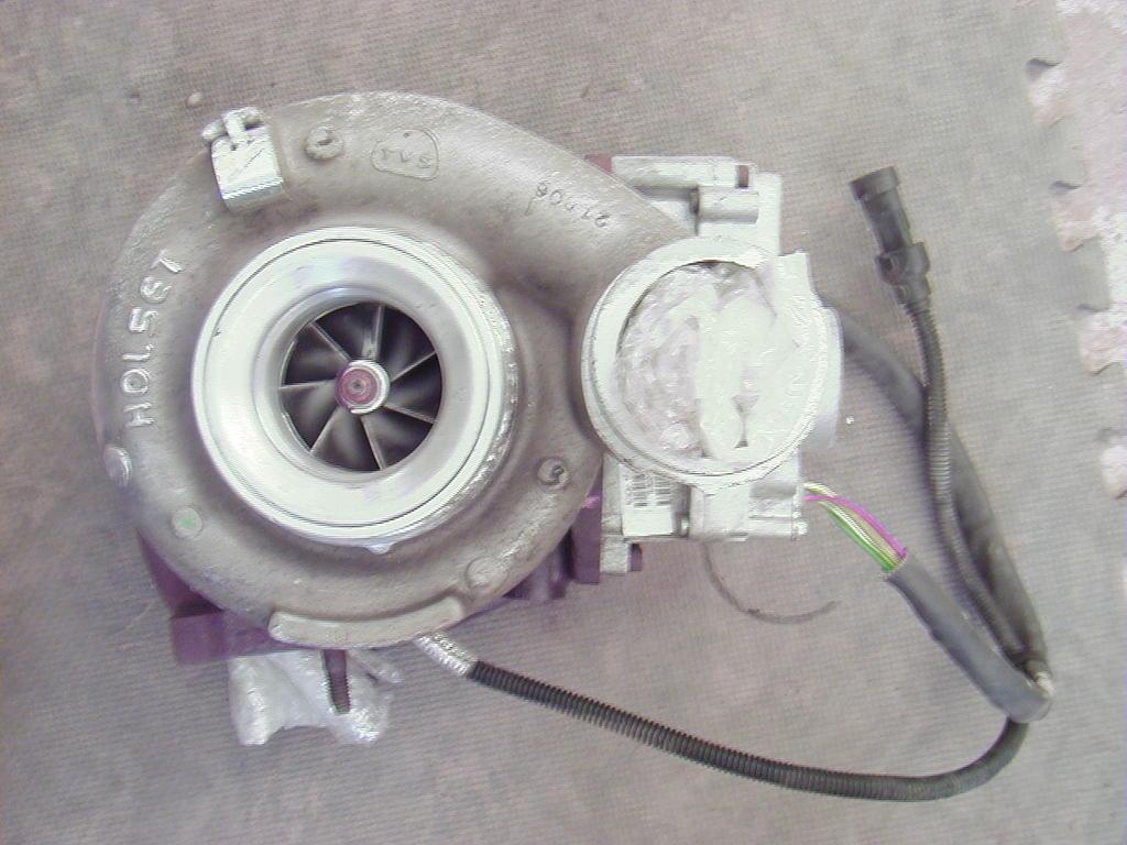

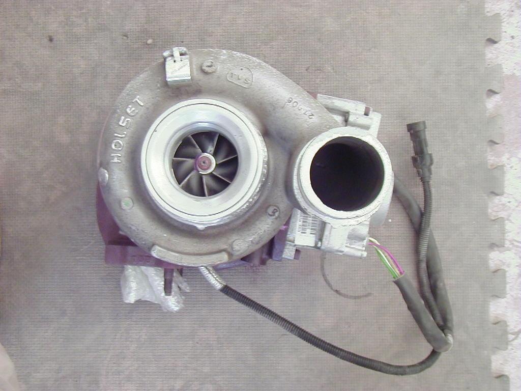

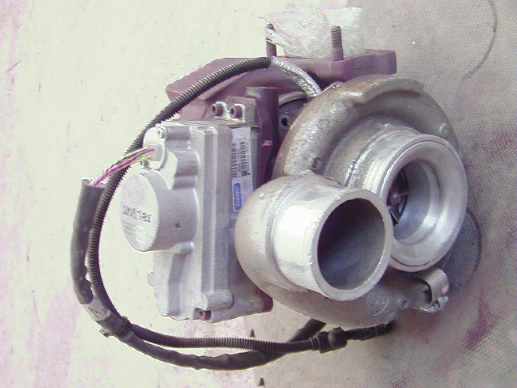

RD, I have a very low mileage HE351ve turbo that came off a freinds truck at 15k. I bought it because I was gong to be installing the VGT turbo on my 5.9, but have since been able to get an upgraded VGT turbo from another friend. It is VERY clean and young, as far as these turbos go and was working when it came off. It was taken off by the original owner to be replaced by a single, alrger non VGT turbo While I cannot guarantee that it works, only becuase I have not run it on my truck at all since I bought it, given its condition and age, there is no reason it would NOT be working. ALSO, there is zero end play and only normal axial play on the shaft. It is the turbo only, no coolant lines or down pipe. It is an IDEAL canditate for you to send in to have rebuilt if you so desire, or to take apart and learn how to clean yourself. It is NOT that hard to clean these things when they are off the truck. Anyone who is even slightly mechanically inclined and imbued with common sense can do so. If you are interested, you can PM me.
Here are a few pics--
